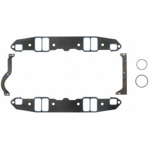

I bought (what I thought was an Edlebrock) aluminum manifold for my 1968 318. I tried to install it today and found it doesn't fit. When it is flush with both heads there is like a 3/8 inch gap between the top of the block and the bottom of the manifold. Am I missing something?
What do you think the measurement there should be? The SB intake doesn’t fit flush with the block on the ends. There is a foam seal that goes in there, or you can use sealer.
There's a fat cork gasket for each end that should come in the gasket kit.
Those cork gaskets are meant to be slightly compressed and they measure less than 1/4" right out of the box. IF there really is a 3/8" gap, the heads may have been heavily milled, causing the intake to sit up too high.
Normal assuming with the intake gaskets in place. Most use a good quality oil/temp resistant silicone and don't be shy with it but you don't want it squeezing out into the engine. Don't forget the corners. Also a good idea to put a light coating around the water jacket passages on head and intake.

Routinely, a head of RTV is used to form a wall of that 3/8 height to seal the intake manifold. Run the head of RTV into the four corners and a light coat around the water ports at each end and side of the cylinder heads.
The end seals in the picture above are normally not used. Normally I deck the block for a zero deck height w/the pistons. The intake also gets cut to fit flush. This sits the intake very low. In both cases, the ends seals are thrown out.
There should be a small gap on each end. Gasket or RTV to seal the gap.

Things look different in the better light this morning. There is a small lip on the edge of the heads that is keeping the manifold from seating all the way down. I think if I grind that lip off the manifold will seat better. I suspect I will still need that bead of silicone on the ends though.
You absolutely will need sealant on the ends. I always threw the gaskets out and just filled it with good silicone sealant.
