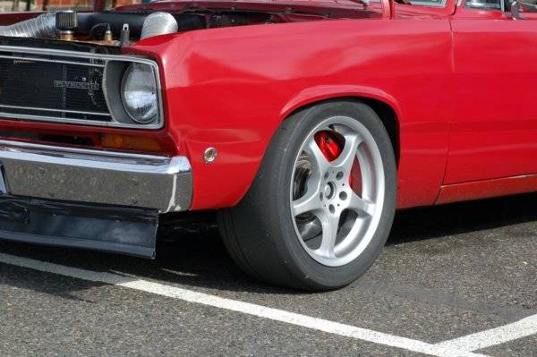

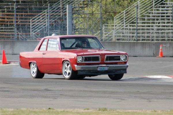

That is exactly what they do. We designed those a few years back as an easy way for Tim to get more camber in his Valiant. Helped make the car stick like glue.
