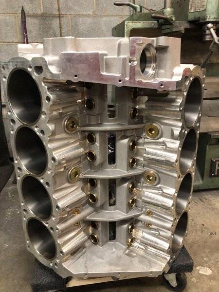

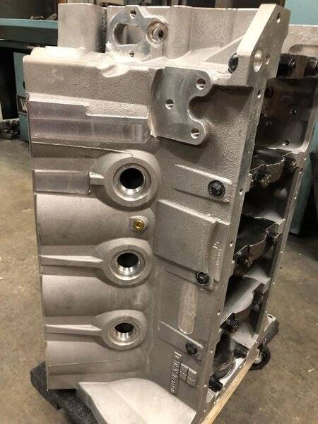

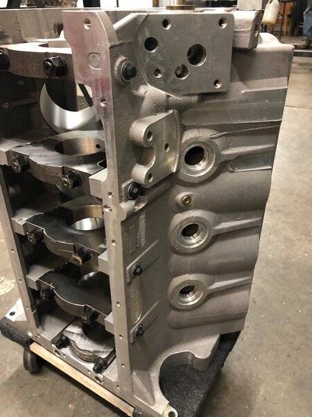

Lookie what I got pictures of this evening!
Not only did I buy my block through Southeast Performance, but he sold me a good bit of the parts that went into my Roadrunner already, like the Viking triple adjustable rear shocks, USCT frame strengthening parts, my Dakota Digital RTX series gauge system and the modules I added to it, and more.I think good practice is to purchase your block through the machine shop you’ll have doing the final machining.

Nice. How big a stroke can that block handle and still be internal oiled? Only reason to get the Indy Maxx block would be if i wanted the short deck.This is the direct quote regarding what additional machining is required:
"these only need lifter bores honed to size, line hone mains, deck and bore"
So that answers the OP question, but I wouldn't consider any of that "fixes before it's ready to assemble". Seems like very basic machining that is involved with any build.
Bill Mitchell Products (386) 957-3009How big a stroke can that block handle and still be internal oiled?
Bill Mitchell didn't know how much stroke could be used with this block and retain the internal oiling. I did call Indy as well about the Indy Maxx block and they claim up to 4.500 stroke retaining internal oiling. The bill Mitchell block comes with bushed lifter bores and the Indy does not. I found a Bill Mitchell block for $5400, quite a bit less than the Indy at $6500. I can also get wedge motor mount on the BM block if i want. I use one motor mount on pass side to locate. Thanks guysBill Mitchell Products (386) 957-3009
