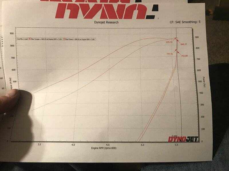

YES! Thanks, again for your reply!well you've seen it before Bio but here it is again, 720ftlbs@4400 at 3800lbs
