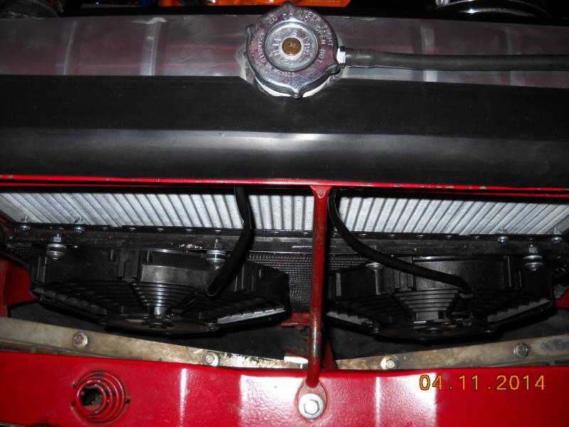

has anyone put a fan on both sides of there radiator????? one to push and one to pull

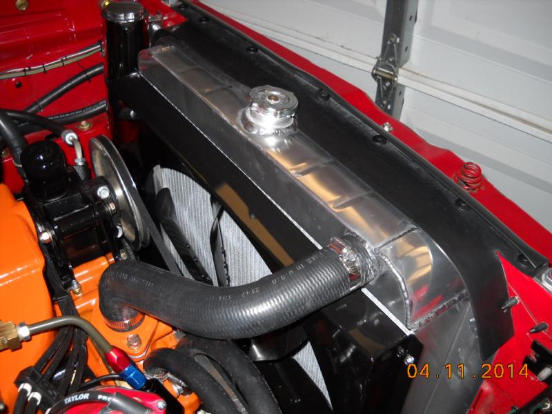

Yep. I have an 18" 7 blade Mopar mechanical fan with a custom shroud on the engine side and two Spal electric fans on the grill side. There isn't enough room to even run the short Hayden clutch unit so the mechanical fan is mounted with a short spacer to get the fan about 1/3 of the way into the shroud. The electric fans (a 9" and a 10") are connected to a sender via a Cen-Tric box that allows me to set the 'on' temperature , currently at 200*. The mechanical fan does the job by itself, except when I get caught idling in traffic on 105* plus days in the Sacramento area. The electric fans will maintain that 200* pretty much forever and then drop out when the traffic starts to move. Works very well for me and gives me 'peace of mind' no matter the weather.

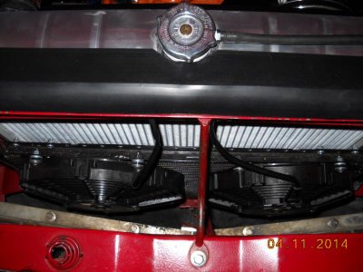

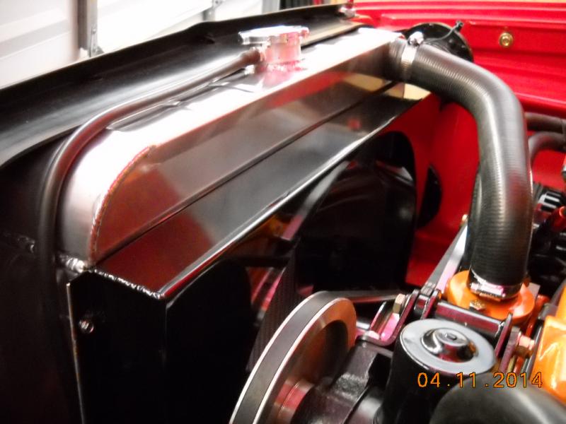

View attachment 274200 View attachment 274201 View attachment 274202
