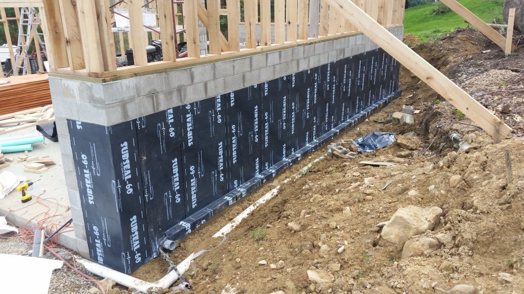

Took advantage of the nice weather to get it sealed up for back fill, this has got to be one of the best parts of a construction job........ Finally filling in the mess!!! This is a product made 15 minutes from me and is a 60 mill peal and seal membrane, good stuff.

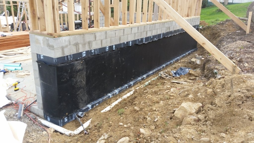

Then the dimple drain sheeting that's just nailed on with a 22 caliber concrete gun.

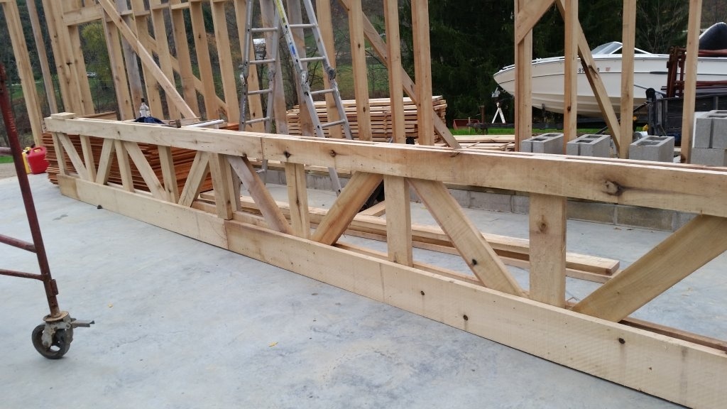

The local truss company wouldn't even consider building a trussed beam to support the second floor so my brother and I threw this together last night, it ain't going anywhere!!! Glued, screwed then a thousand nails.

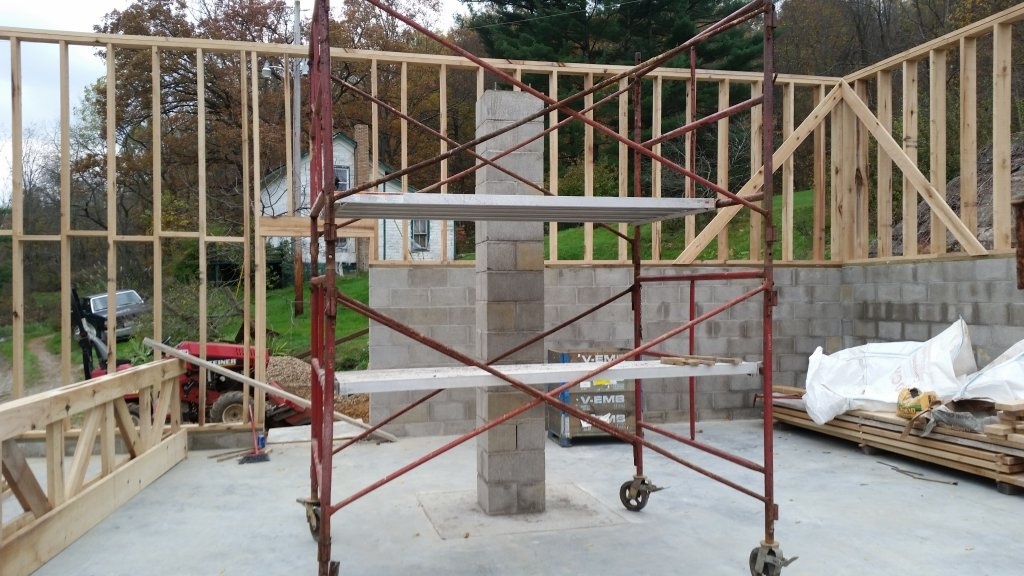

Finished the pillar and poured the core full of concrete with 1/2 rebar.

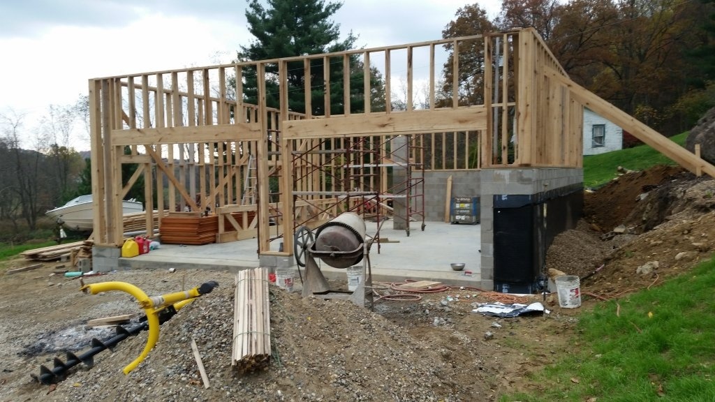

And the beam is up!!! When I got home today my dad and brother were sitting there at the garage, dad asked what we were doing today "sure would love to get that beam up"..... Between me and my brother we were easily able to walk it up the scaffolding and get it set in place while dad used leverage from below to keep it stable. Now I can build the short beam to finish it off by myself and start setting joists and laying the floor.:thumbsup:

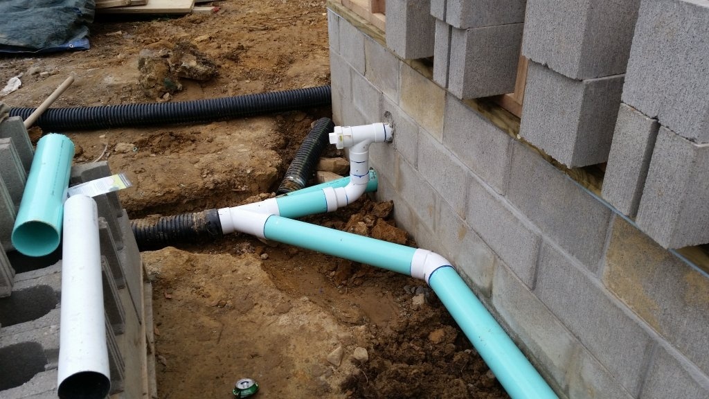

Spent my hours after work this week (couple hours here and there) taking advantage of ridiculouly nice Nov weather putting in the water line and piping for the 200 amp service. With that done my dad can fart around on the Steiner backfilling while I'm at work getting the ground ready to work off of come time to put siding up.

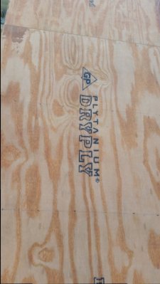

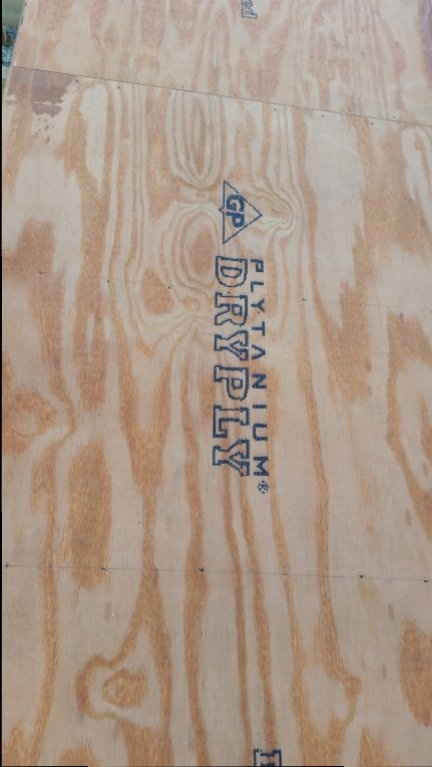

I hate marketing ploys, PLYTANIUM cause it's made out of titanium and stuff lol!!! Goof balls

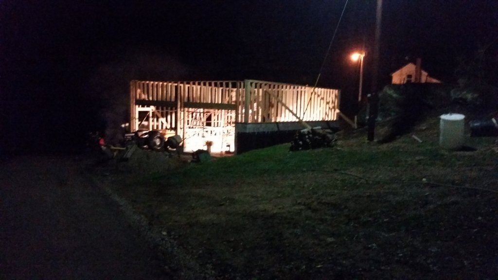

This is the best I could do for a pic, it was dark when we stopped. Side by side garage door needs a bit more framing upstairs but it's pretty well licked.
