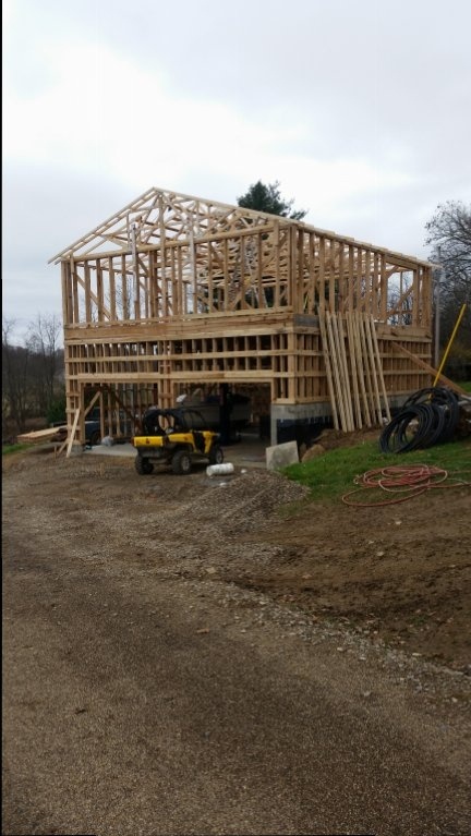

Almost made my goal but close enough to put a smile on my face. Took longer than I thought tidying up the upstairs framing, adding bracing, installing the top sill and squaring it up but got it done. We got about half the trusses set but anybody who's ever laid trusses knows the first couple are the hardest, it's on now! Got a better pic in the daylight too. Gotta admit it's looking more like an apartment lol. Honestly thinking the upstairs will be best served as a game room, pitching machine and pitching area set up for my daughter so she can practice during the winter and maybe a ping pong table, pool table, etc but still parking for the Can Am.

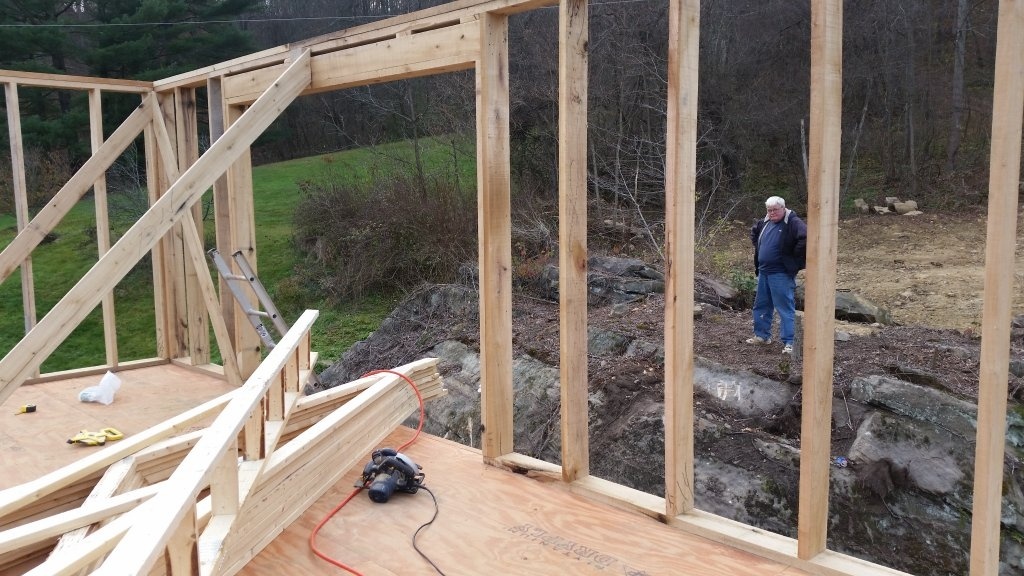

Need to start thinking about the bridge, you can see the span in the pic with my dad standing on the rock. Going to keep my eye open for an old mobile trailor frame or something along those lines to start with. My coworker who attends flee markets and auctions sold me an insulated 9ft X 7ft garage door for $100 still in its wrapper so I'm good there now.

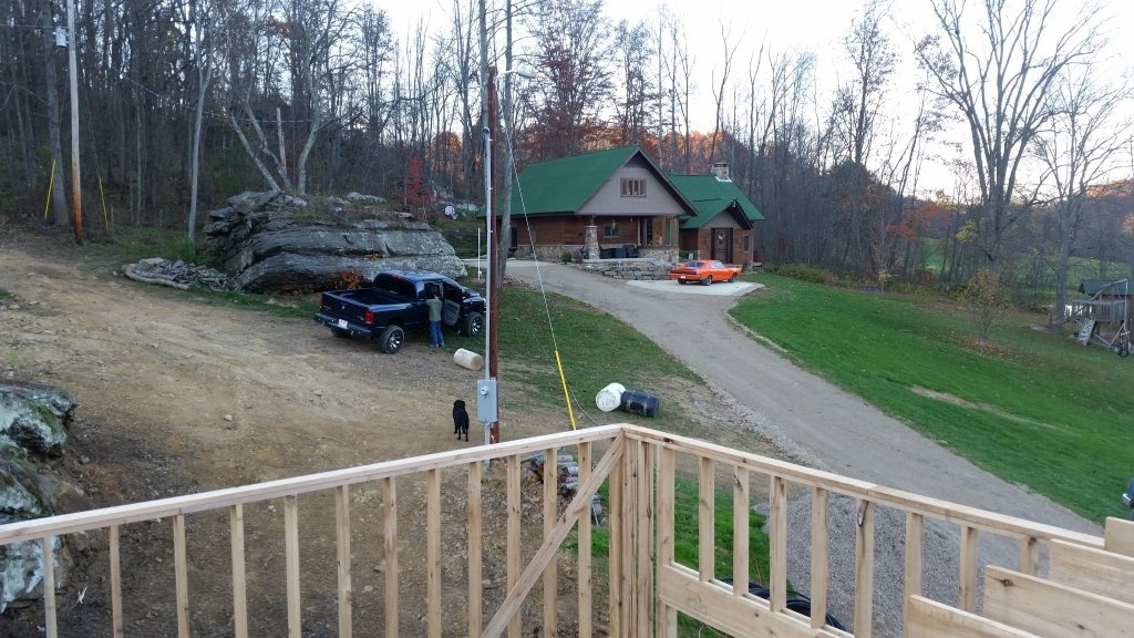

Looks like the guy next door has a sweet Charger..... :rofl:
20161106_163059-jpg.372269
J/K - I know it's yours. :thumbsup:
I'm just tickled to death that I'm still driving it in November, with the weather we're having I'll be driving it on Christmas day!!! A bit cold in the morning though, this was this morning taking the kids to school.. 29 degrees and the race carb with no choke fired right up:thumbsup:. Wearing a T shirt by 1:00!
