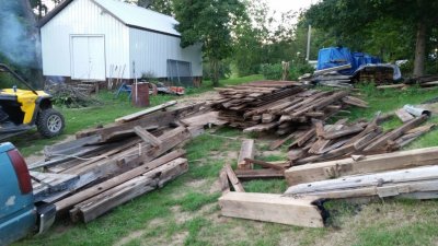

I haven't posted pics because there's not a lot to see yet but here's what I've done so far. This is the barn that had to come down, the tall section is a typical barn made from Chestnut, the addition was just poll barn construction. I saved the Chestnut, scrapped the siding and burned the rest. My excavator has proven to be very unreliable so who knows when he'll get done, he's digging at the moment.

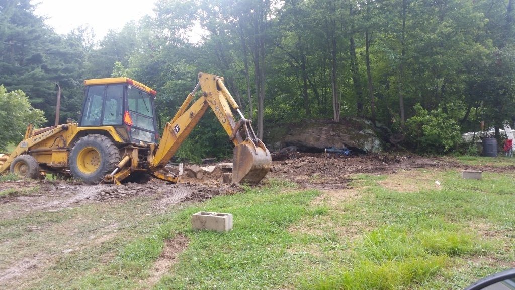

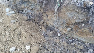

Finally some progress:D. Woke up Sun morning and stacked a load of fresh cut Poplar then worked till 8:00 on cutting down trees and burning all the tops. Thanks to my brother in law it all got done because without his help I doubt it would have. The excavator busted butt today and mostly got the whole area leveled for construction to begin. No surprise he hit one small spring but a small spring this time of year typically means a healthy spring in the Spring so that'll need addressed. Looking good, got next week off so hope for some progress.
Here's the Wormy Chestnut I saved from the barn, really cool getting my hands on a wood that's non existent anymore. Got plans for building a kitchen table, chairs and more out of it.

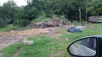

This is after the trees were cleared, liked it better before but trees rooted in the thin soil on a rock is bad news not to mention the mildew that the garage would grow with no sunlight

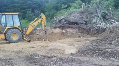

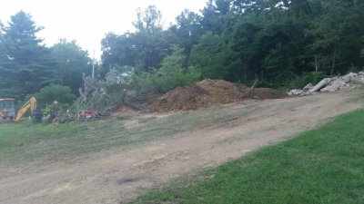

Can't believe this mammoth mound of dirt. Great.... the yard is getting bigger meaning more mowing!
You can see the notch where the garage will go finally, looks like about a 4ft concrete wall will be needed.
And this is no surprise to me at all, I live on top of an oasis! I swear every time I dig a hole I find water.
Here's a better shot from on top of the rock, I've got cement blocks roughly marking the footprint. You can see the space restraints I have here because of the driveway's.
This should be enough rough cut poplar to build the whole thing minus the post for the 24 X 24 section, can't order them until I see the final grade if I want the wall heights to match.
nice looking piece ground........ what part of the state is that?
