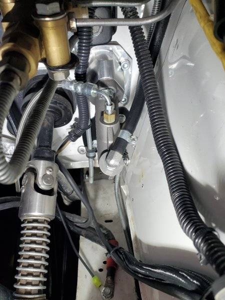

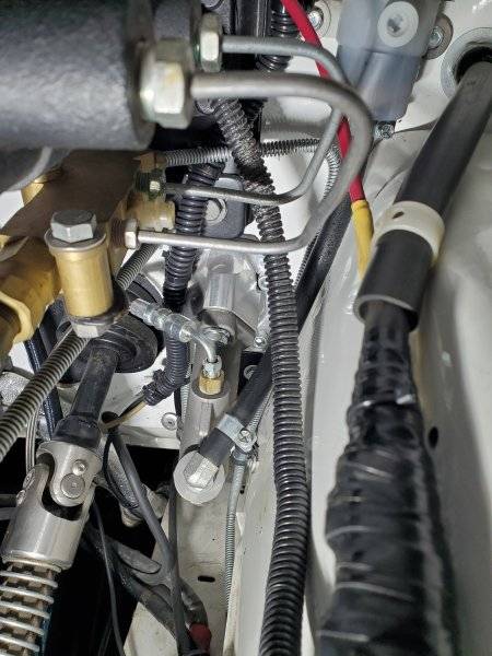

Rather than using the original clutch linkage hole to mount the clutch master cylinder as per SST instruction, we cut a hole and mounted it up closer to the brake master cylinder. Made the connecting rod angles doable. 64 plymouth savoy.
It’s something I’ve considered. I’ve sent pics and additional requested info. to SST and they are looking to make some type of adaptor for me. I do find it odd however, that I’m the first person with an early b body to enquire about this issue. Surely I’m not the first person to order their kit to fit a 62 - 65 b body.

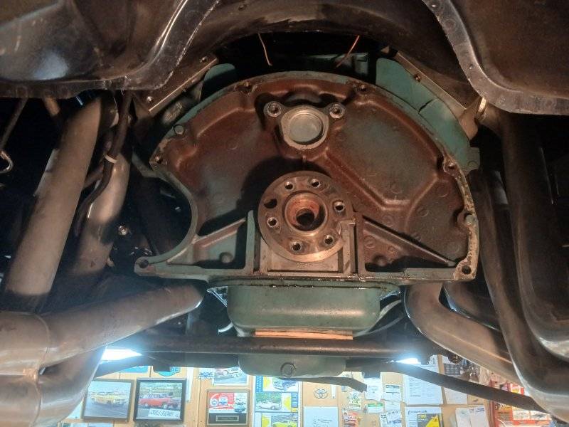

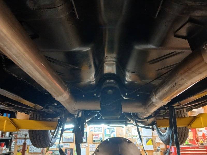

So while I await for the above issues to be sorted out, I have moved on to the other tasks at hand - auto trans removal. The trans fought me every step of the way. Had to cut the H pipe because it was 1 inch to forward to clear the tail shaft of the trans. Had to unbolt the drivers side header to gain clearance and many other small details, but she's finally out.
With the auto trans out, it was time to tackle fly wheel and bell housing runout.
I cleaned all the paint / rust on the back of the block where the bell housing mates to it as well as cleaning up the crank flange.

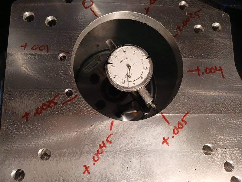

After mounting the flywheel, I installed the bell housing, again using 2 studs to help align. I then set up a dial indicator to measure flywheel runout.
Total runout was .0015
Next I measured the bell housing runout - I was hoping it would fall between specs (.005), but lucky me, it spec'd out at .006. Removing the existing dowel pins is going to be ugly - vice grips are not going to do the job. I pray I don't have to remove the engine.

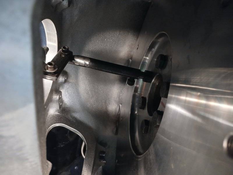

You can see this nifty tool I made to hold the dial indicator - it's not my idea however, 1 Wild R/T gave me the idea - see link - Bell housing runout

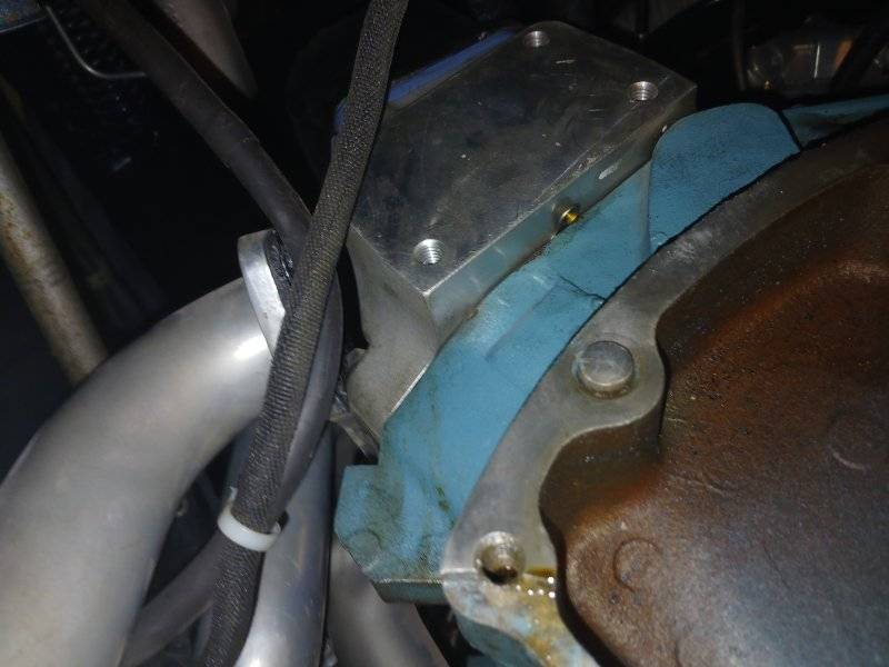

Todays job was to remove the factory engine block dowels. Vice grips didn't budge the "long" dowel and the other dowel only about 1/8 inch proud of the block.

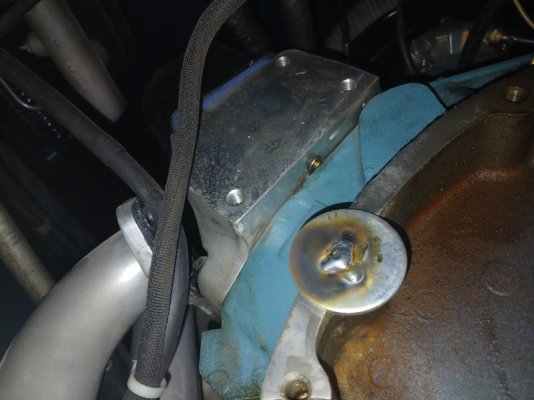

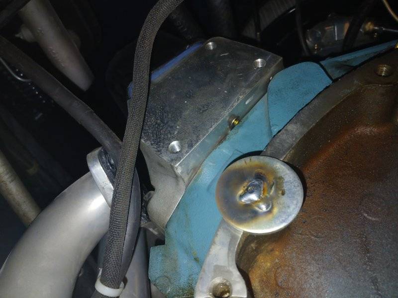

After scratching my head for 15 minutes, I decided to weld a washer to the dowel.
Then, a nut was welded to the washer.
I then used a screwdriver as leverage behind the washer while turning the nut with a socket.
They both came out easier than I thought, which was nice. Sometimes things go your way.

I received my offset dowels (.007) this week and installed them. First crack on the dial indicator read .005 TIR - so .0025 total run out.
I know that I'm within required specs (.005), and I'm at .0025, but I may try to get the numbers closer to zero if I can. There are members who have struggled with getting their numbers within specs and have spent a lot of time getting this right, but maybe the stars were just lined up for me.

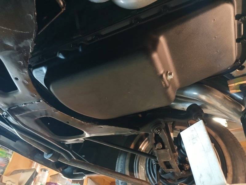

While I have the trans out, I took the liberty to change out my oil pan from a 4 qt, unbaffled 187 pan to a baffled, 6 qt max wedge pan.
Unfortunately, I was unable to keep my windage tray - they don't agree with each other.
As I was installing the new pan, you guessed it, I pulled the threads out of the block on the last pan rail bolt, which also happened to be the hardest one to install (above the cross member). I wasn't going to accept engine removal to fix this, so I was able to install a bolt that was longer than the original and was able the catch enough "good" remaining threads. The last few turns of the socket was a little nerve racking.
