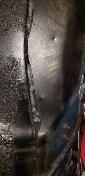

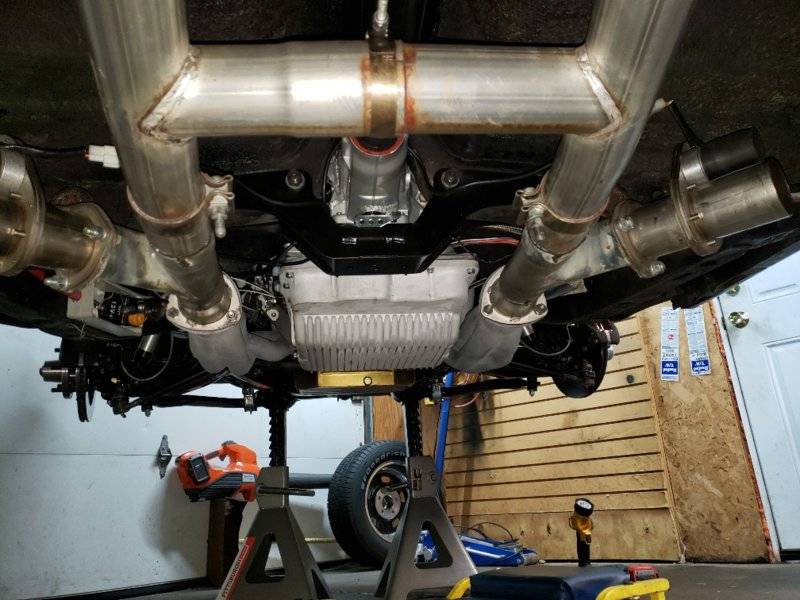

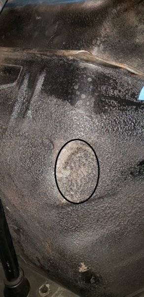

Started job but one thing leads to another. Swapped my 3:73 back in while drive shaft was out. All mechanical stuff is done, A dimple and Bend of the tunnel seam were all that was required.View attachment 727626
Transmission went in easy after the fold and dimpling. It was very easy using a transmission jack.

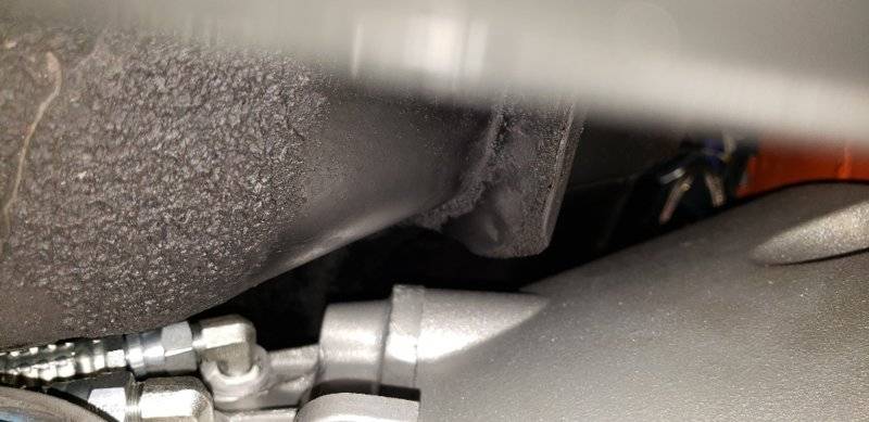

last two pics are of areas that needed to be bent or dimpled after transmission was installed.

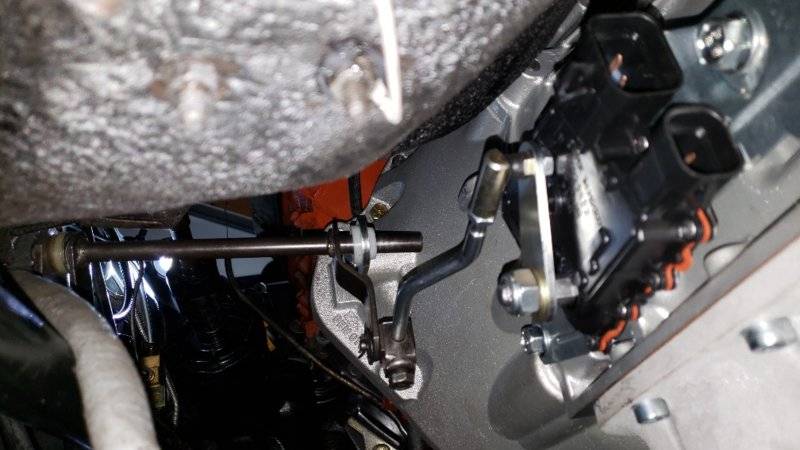

Shift linkage

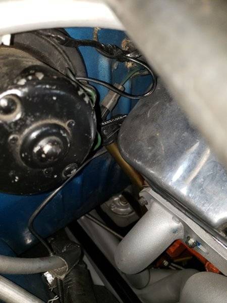

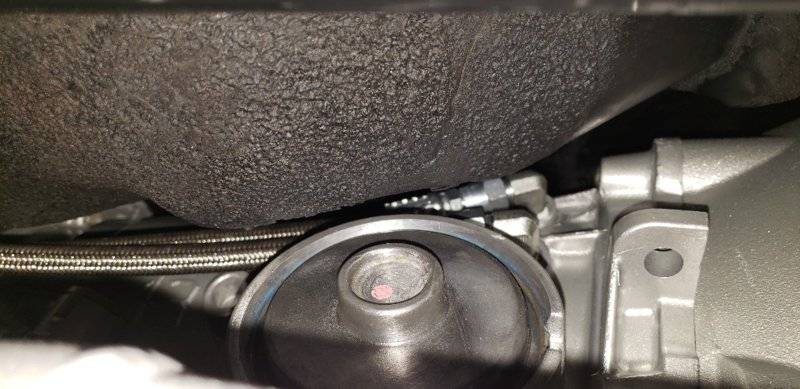

The Dipstick tube is one thing I dont like it is in a very awkward location.View attachment 727632
Shift linkage
