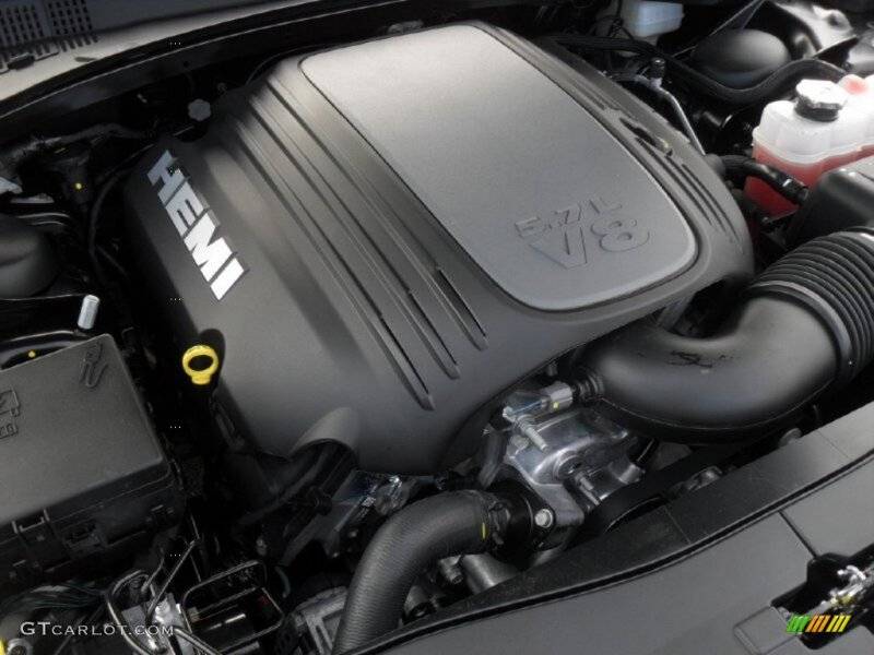

Just a quick pic of the typical 5.7 engine bay of a Charger, though - to show what I mean about 10 pounds
of shiyat in a 5 pound bag:
It's friggin wall to wall in there....but I do love the car itself. It's a hoot to drive,
has all the gadgets and is comfy for a man-sized adult.

Is there an engine in there?
