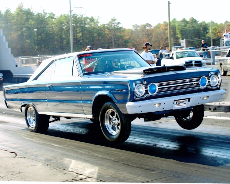

I have Caltracs. 2 flats preload on pass side and the space the thickness of a nickel on driver side with driver in seat.
9 x 28 M/T slicks
I'm pleased with how they perform.

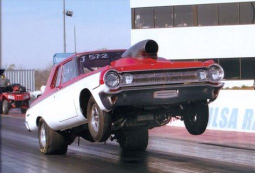

Yes, we are. We are using the mono leaf spring and cal trac bar. The stock spring mount can stay. Cal trac tech will give you all the info you need. They work perfect on our car. Best pass with cal tracs 8.96@152
