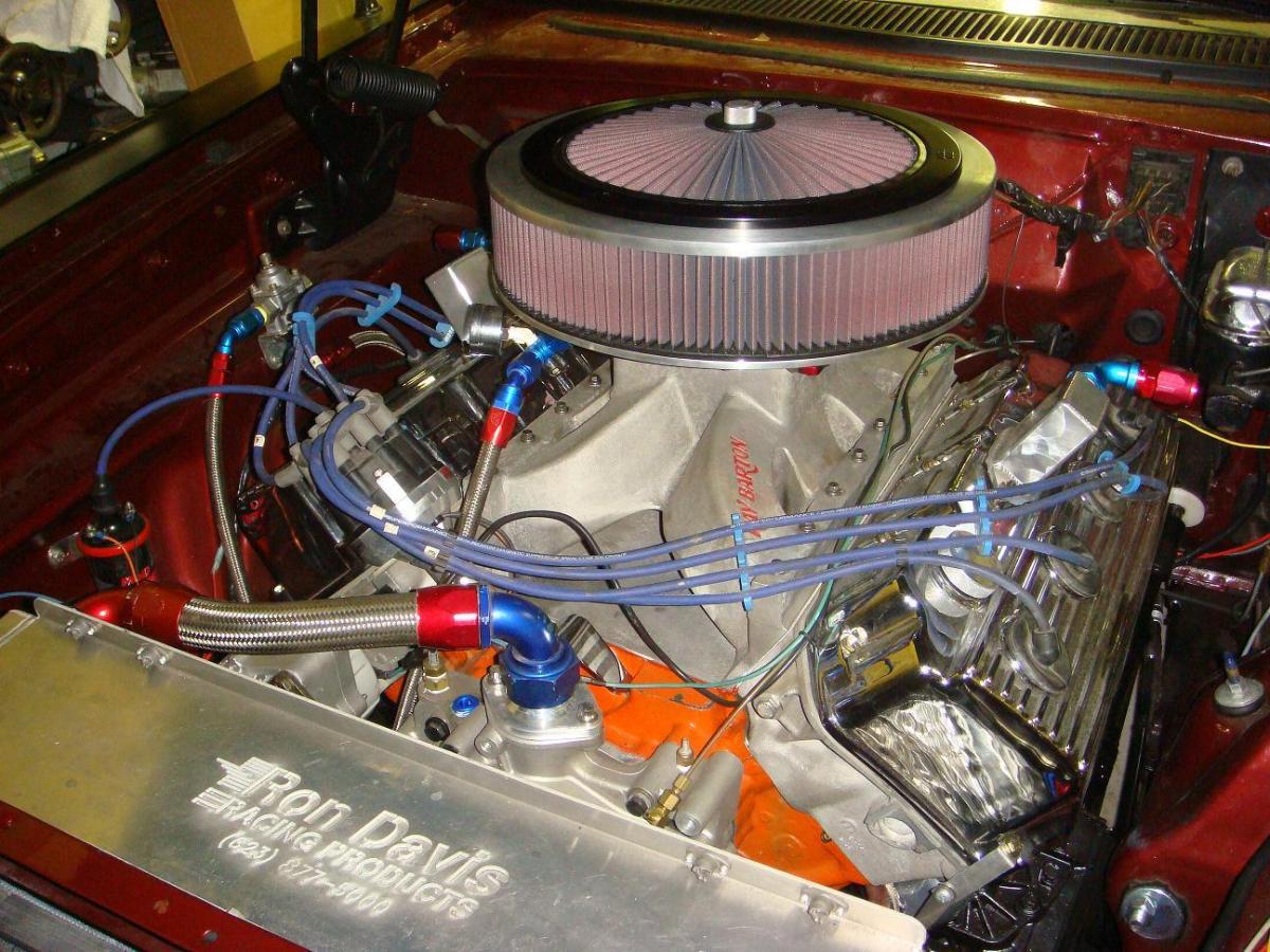

Finally got the engine in my 64 Dodge Polara. I went with a '69 K-member, which put the engine back against the firewall (where it belongs); modified the trans X-member for set back; added frame rails and boxes from ART; all new front suspension and brakes; put a stout radiator in it (the '69 K-member allows plenty of room for upgrading the cooling system); just worked to make several overdue repairs to prepare for cruising this spring.
I've included a pic, and a link to a short youtube clip of the car. The engine had just been fired up in the video - with tuning still required.
http://www.youtube.com/watch?v=mM7Pk1G7u_c
The car does need some help with the rear suspension. I think it's got the stock leaves with the right rear biased by ~1", which annoys the fire out of me. Anybody got recommendations on the best rear set up to run these days?
The engine dyno'd at over 800 hp and almost 800 ft lbs at 7100 rpm, while making over 660 hp from 5000 rpm up. I'd like to hook it, if possible.

NICE RIDE!!!!! Sounds real good. How big is the motor? 800hp and 800ft lbs of tq it has to be big.

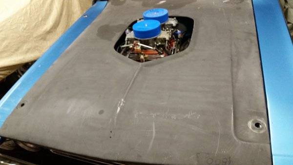

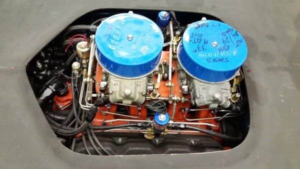

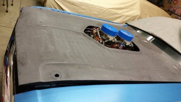

Found my shaker hood this weekend. Now I am making a custom drop base & shaker scoop to fit the Dominators.

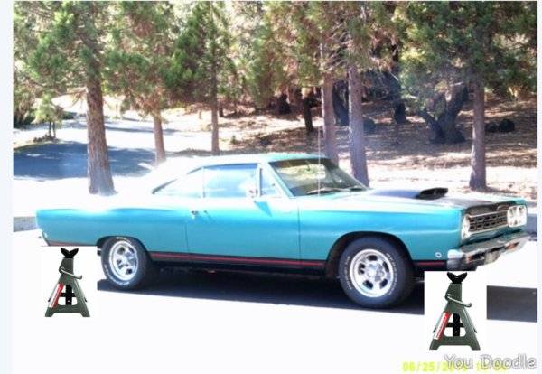

Does color/paint count
still no jack-stands either

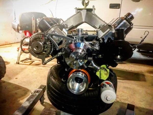

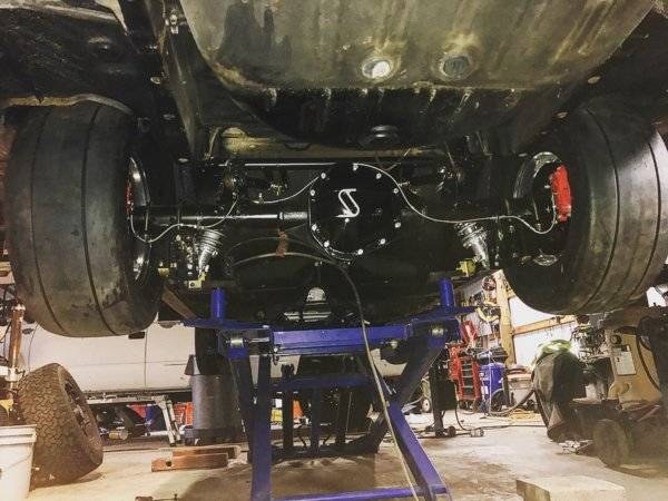

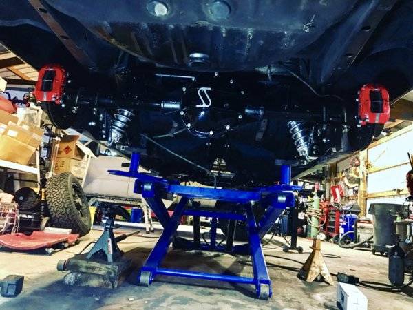

Ehh getting close, New engine, trans and rearend. New wheels and wilwoods on all 4 corners. New 4 link out back and rebuilt front suspension. Might get it off the lift by may.
