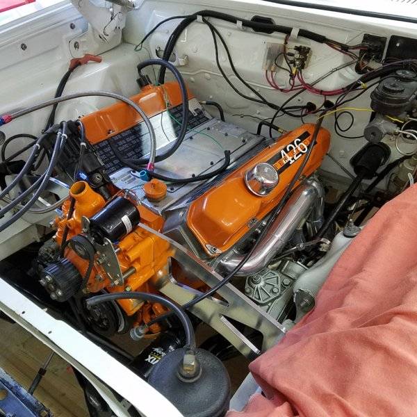

Been a slow process, broke the ring and pinion, that trashed part of the transmission, decided to freshen up the motor. got some parts powdercoated
Thanks Joe, hope to see you at the races
LOL... This is his son Kevin. We broke a rod at Norwalk last year... I would like to get out this year but it's not looking good... at least early on.
I did get a block which I was lucky, and I got the head fixed so that's a start. Now it's up to what my wallet will allow. I would like to be out before the end of year, we'll see how it goes.
Good Luck this year!
It's in and running, took it out today for test drive. Runs great!

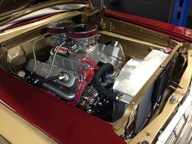

racing with air cleaners..makes sense,i guess if u r not looking for that last ounce of bottom e.t. then better to be safe than sorry..i was thinking of using a velocity stack base and wire mess and foam over it,something like in the pic...
any thoughts...
racing with air cleaners..makes sense,i guess if u r not looking for that last ounce of bottom e.t. then better to be safe than sorry..i was thinking of using a velocity stack base and wire mess and foam over it,something like in the pic...View attachment 584988 any thoughts...
There’s a great air cleaner / dyno test out there. Sure shows what works. The foam top didn’t fare too well. The top element on a velocity type stack was #1.
