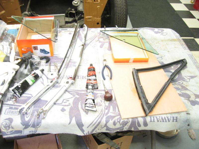

How big was the job of rebuilding the wingvents. Looks like it would be a big job taking them apart and putting them back together.
Hey Ga66 . Its really not too bad. After you have them pulled from the door, you pull the screw from the swivel , then pull the roll pin from the lower shaft. It will then lift out of the frame. You can remove the glass from the channel by heating it. I used black silicone on reassembly. You then pull out the old weatherstrip out of the frame, which can be purchased aftermarket or reuse originals. Now you must seperate the chrome front leading edge part to be chromed from the rest of assembly. I did this by grinding down the rivets visible inside of the channel with a cutt off tool. You will notice that Ma Mopar provided an extra set of pins for you to peen over on reassembly. I actually used my arbor press to peen over the pins after I protected the new chrome pieces with towels.
