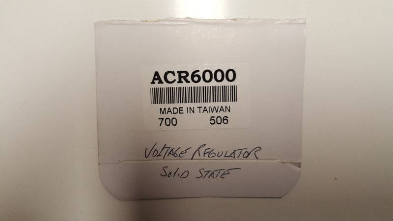

I bought the one mentioned in the ebag link. My battery kept crapping out, parts store tested and warrantied the alt then batt.
Put the new vr in and charging perfectly and can easily adjust when accessories on.

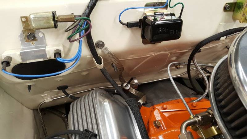

I run the newer Mopar two isolated field wire alt and regulator which you can see in this pic. It works fine for me as I have run it since 2006. Ron
