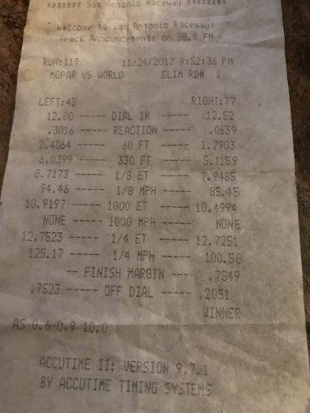

The last time slip I could find.
I’m 77 on the right.
A good 12.50 ticket in a 3700lb car with a med to good hook would look like this,
60 Foot E.T. : 1.74
1/8 Mile E.T. : 7.89
1/8 Mile Trap Speed : 86.15
1/4 Mile E.T. : 12.50
1/4 Mile Trap Speed : 107
