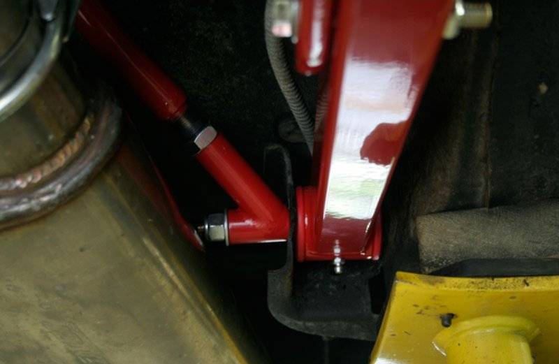

Lower lift bars, brackets deleted because Quick Performance is building in the multi position bracket into the rear housing. I don't quite understand how they work, so maybe y'all can help me understand, but they induce greater downward force on the rear tires for better traction:
Any input on my question about how these lower arms with their flexible mounting helps traction is appreciated!
Here's what UMI says:
"Lift bars work with axle torque to load the chassis of the car, forcing the rear wheels downward pushing the tires into the ground resulting in harder launches and improved 60-foot times. The UMI lift bars are designed to improve traction and reduce unwanted wheel hop."
Bushings and brackets reduce flex. Now you have a solid platform. Multiple holes allow the instant center and pinion angle to be adjusted. Raising the instant center causes the rear of the body to lift applying more load to the rear tire. Lengthening the instant center lessens the violence of the hit. The greater the power the lower and longer the instant center needs to be. Google 4 link instant center to get a clear idea. Then ask the manufacturer of the components for a initial setting.

Doug, thanks a lot!!!
You are one of the guys who seems to always be reliable for good, detailed information. I really appreciate it!

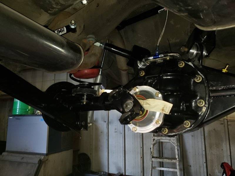

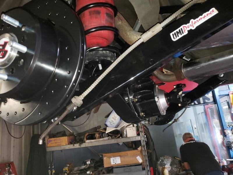

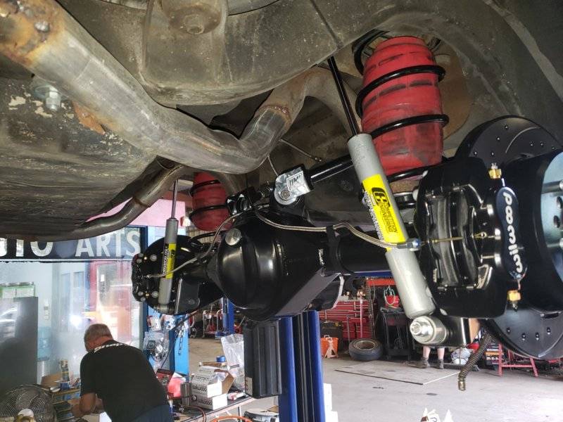

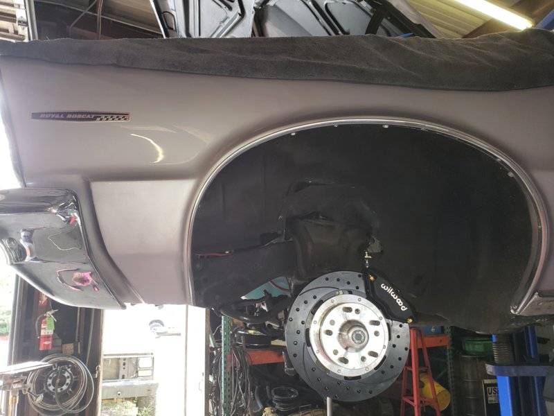

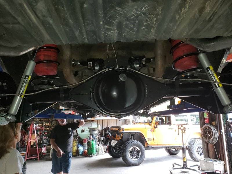

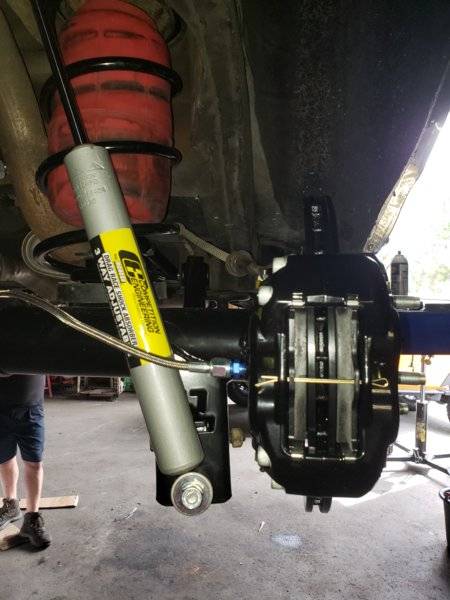

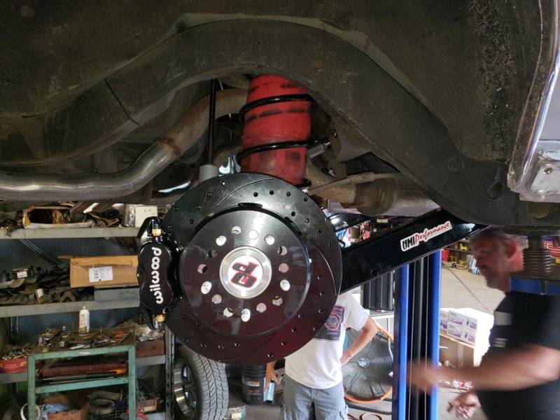

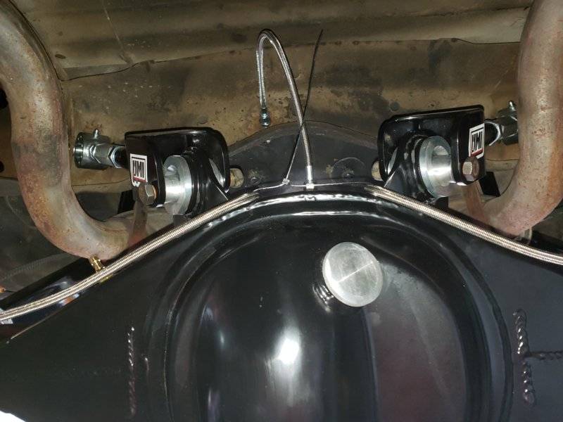

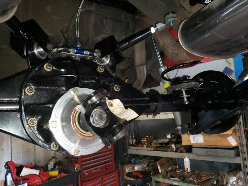

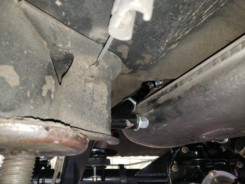

Got some pix today. The UMI suspension, Wilwood brakes, and Quick Performance rear axle assembly are coming along. Crusin the Coast starts this weekend and runs through the week into the next weekend.
The parts and installation look top notch!
