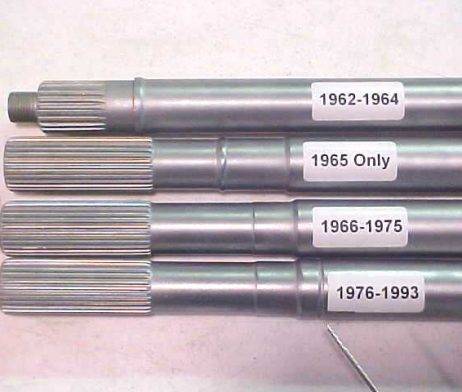

Spline count is the same, as I recall, but some yokes are vented and require a seal on the output shaft (seals to inside of yoke). The non-vented yokes have a missing spline to provide venting.

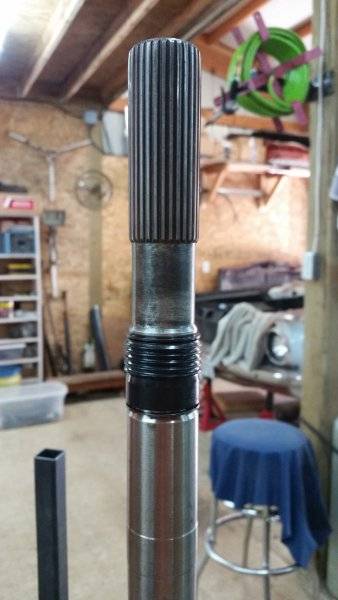

The later yokes work. However they are longer. There is a ridge on the 65 output shaft about 1" in front of the splines. The ridge will limit how far a late yoke can slide into the trans. I cut off about 3/8" from the front of the yoke. A $10 cutoff wheel blade at Lowes mounted in a miter saw works great. Just go very slowly.

Since I've never actually used a 65 yoke, I'm not sure. We have raced 65 727's since the 90's. All with late yokes. Non use the seal shown above in our configuration. None of them leak a drop.
