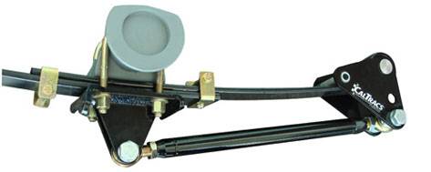

Calvert Caltrac's on mono leaf

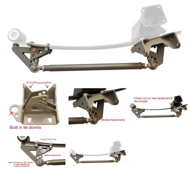

Smithracecraft Assassin on the mono leaf
For as low as my 66 Coronet sits I'd be afraid to use the Assassin bars on the street.
they do appear to stick down a bit more/lower than the Caltracs

The Assassin bars apply force to the spring at the eye, the Caltracs to the spring.
It doesn't matter how "good" the Assassins are if I drag them on stuff, curbs, etc...that's a no go. Same for the Caltracks, but I already know that isn't going to be a problem, because I've seen cars with them on the street.
So I have to find out, if the Assassin bars hang lower and if so, how much, and then BAM! If the clearance is acceptable, Assassins get the nod, if not, I'll get the Caltracs and be happy with them.

Ok from the center of the spring eye bolt to the bottom of the front bracket is 6 1/2".
On my car, it's 8" from the bottom of the bracket to the ground.
