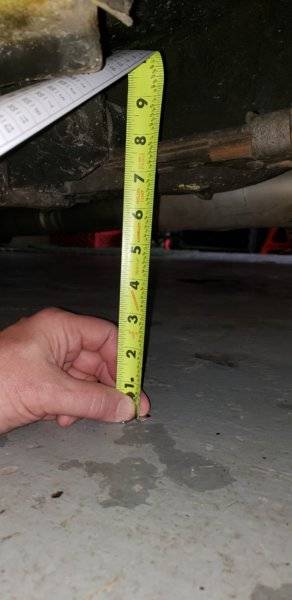

Ok from the center of the spring eye bolt to the bottom of the front bracket is 6 1/2".
On my car, it's 8" from the bottom of the bracket to the ground.
My car currently sits 8½" from the center of the front spring eye bolt to the ground.
The Caltracs bars are 5" down, Assassins are 4 ½" down, and Caltracs low profile are 3 ½" down.
I'm ordering the Assassin bars tomorrow.
I'll never have a shorter tire or sidewall than I do now.
My choices between the low profile Caltracks and Assassins leave me with 5" or 4" of clearance to the ground, respectively.

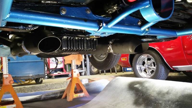

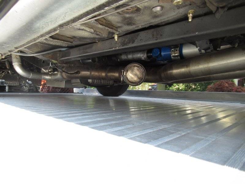

That's more than my oil pan has:lol:
Right?!
I think my Doug's electronic cutouts are closer to the ground. I'm used to being aware of those, and they have scraped my trailer where the ramps meet the main floor of the trailer. I won't ever have a smaller diameter wheel and tire combo than I have now, so I think I'll be OK.

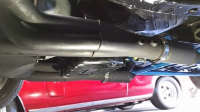

I have -1" split mono''s on the rear of my Challenger. My car sits nice and low for having a 30" tall (315/60 D/R). My caltracs are not the lowest portion of my car. The mufflers/turn downs are. Straight off of the collectors from big tube Hemi Headers.
