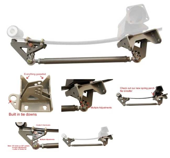

The Assassin perches look interesting because they are "no U bolt style" or should I just use the stock perches?
This is going to be a total re-do of the rear suspension.
My main question is Assassin traction bars or Caltracs traction bars?
There are several holes in a couple of locations for additional adjustability for the Assassin bars, gusseted TIG welds, built in tie down loops, and they are said to have greater leverage than the Caltracs bars. The Assassin bars are maybe 3/4 to 1" lower at the closest point to the ground, but that may not be a factor.
What can you all tell me about either, especially interested in anyone who has or has used the Assassin bars.

U bolt-less perches. Pretty cool, but should I replace the stock perches?
I just purchased a set of Assassins.
The front lift point on the spring eye looks like a better design.

The tie down hole on the Smith bar is sure going to be handy as well.
It was cool when I called the first time today, Mr. Kim Smith, of Smith Racecraft, the "Assassins guy" was placing orders with vendors, but they said he'd call me back. It turns out we shared the same "stompin' grounds". Anyway, it was a very patient and informative call, and I have talked with other members of the MOPAR nation, and I'm going with the Assassins.

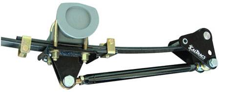

completely different style of traction bars
or the way they attach or apply the leverage, or act & preload even
just for comparison sake,
side by side (top & bottom)
what's the difference (????) that's the $64,000 question
Calvert Caltrac's on mono leaf
vs
Smithracecraft Assassin on the mono leaf
they do appear to stick down a bit more/lower than the Caltracs
