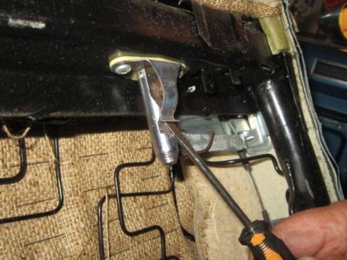

I found this photo on FABO:
I just rebuilt my bench seats on my 68 roadrunner. the clip (spring steel) is a little different, but it just goes into a small detent slot on one of the rods. I would do as others have suggested with some wd40 spraying down the rod. only one of the rods has the detent. yes, slide the headrest down and just quickly yank it up and it will come out.
