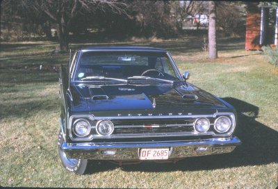

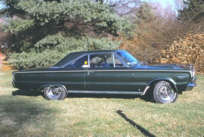

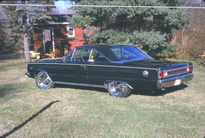

Part Three - Now the 67 ran, hooked and stopped good but it looked pretty bad. The green paint was faded, it had a silver drivers door and trunk lid, and big white vinyl "Plymouth" decals on the quarter panels. The body was actually pretty good for an Illinois car and had no visible rot but some surface rust. I pulled off most of the trim, stripped it down and resprayed it the factory green in lacquer.
Back then I still lived with my parents and did all my car work in their one-car garage. Any painting had to be done outside in the driveway and had to be lacquer so I could sand out the dirt and bugs. This was the first car I ever did a full repaint on, I had to wait for a day with no breeze and I wet down the driveway. It actually came out surprisingly well although I had to buff a lot of paint away since I hadn't discovered clear yet.
So now it looked good and you would think I was done with it, but like most guys with musclecars in the 70s I just couldn't leave it alone.
TO BE CONTINUED...

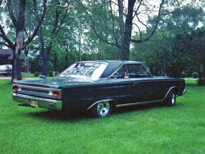

Part Four:
Back in the 70s there was no such thing as a "stock" musclecar. The first thing everybody did was modify them in some way, either visual stuff to personalize them or mechanical stuff to make then faster. I was actually pretty lucky, when I bought my 67 GTX it still had almost all of its original parts, except for some bald white letter tires and those white vinyl "PLYMOUTH" decals. After I painted it the first thing I did was add the Ansen Sprint aluminum wheels and wide tires you see in the photo. Of course I didn't know anything about wheel offset so they were too wide and rubbed the inner fenders. I pounded on the fender lips, put extended shackles on the rear springs, and cranked up the torsion bars in the front. Now it looked like a gasser, rode like a truck, and cornered like it was going to tip over. It didn't take long for me to realize that looking cool wasn't worth all that. I put the steel wheels and hubcaps back on and put the suspension back stock - boy did that car ride and handle great! Later on I was able to buy a new set of stock size Magnum 500s and Firestone F70-14 white letter Wide Ovals which stayed on the car. Those date-coded steelies went out with the trash and the perfect OEM wheel covers wound up on some used car I flipped - back then nobody thought to save the stock stuff. I think I also added a stereo FM radio to the car, I can't remember if it had a tape deck but I do remember cutting up the front door panels and the package shelf for speakers. I did that on just about every car I owned through the 70s and 80s - pretty cringeworthy looking at it now. Next step - performance mods!

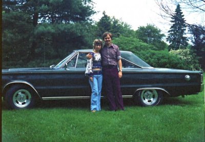

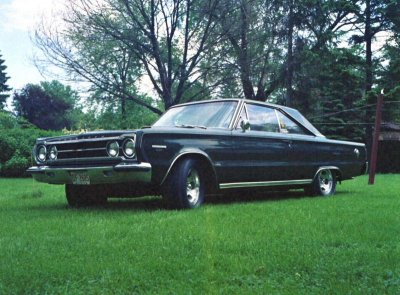

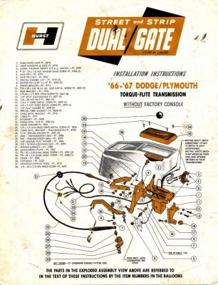

In the late 60s and 70s musclecars were everywhere. The Hemi's and LS-6's were always rare but the rest were common as dirt and the older ones were just as cheap. Everyone wanted to go faster and performance mods were the first thing everyone did. My first 67 GTX was no different, the first thing I did was add a B&M shift kit to the 727 for firmer shifts. Then I replaced the column shifter with a Hurst Dual Gate on the floor. It came with a trim-to-fit plastic console and looked and worked great. Those two mods stayed with the car as long as I had it.
Next came the motor. I pulled the top end apart and put in a purple stripe "Hemi" cam and a 780 Holley dual feed on an Edelbrock Tarantula manifold. It sounded wicked but was no good on the street - low end torque was gone and not enough vacuum for the brake booster. This was my daily driver and I didn't want to change the convertor or the 3.54 gears, so off came the speed stuff and I put it back stock. I did add an electronic ignition conversion out of the Direct Connection catalog which stayed. I found a mail order surplus outlet that sold factory parts dirt cheap so I tried an AVS carb, then a Thermoquad, but went back to the old AFB every time. Then I found a used Six Pack setup for $75 with the air cleaner but without linkage. I went down to Mr. Norm's Grand Spaulding Dodge and bought the linkage parts (I lived near Chicago then). I rebuilt the carbs, bolted it on and went out for a test drive. I floored it and all six barrels opened, what a sound! I took my foot off the gas but it kept right on going, at about 5000 rpm I had to turn off the ignition - turned out I had forgotten the little spring clips on the outboard carb closing rods and they wedged the carbs open! I kept the six pack for awhile but it always ran too rich and idled poorly so eventually it came off too and the AFB was back. I never raced the car but on the street I always felt the factory setup was the best.
