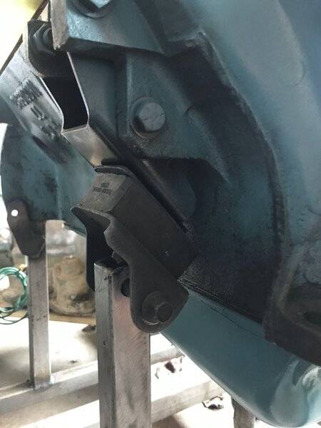

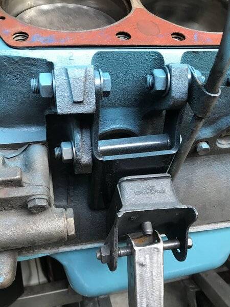

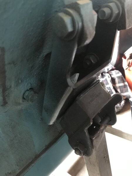

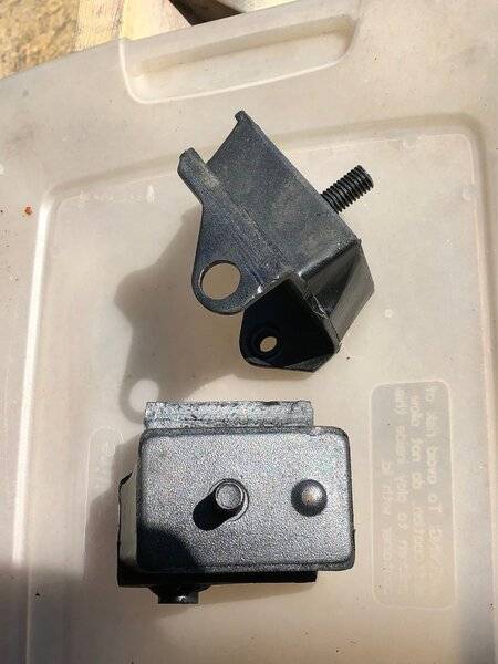

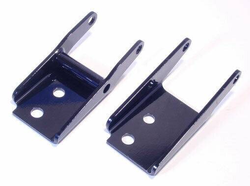

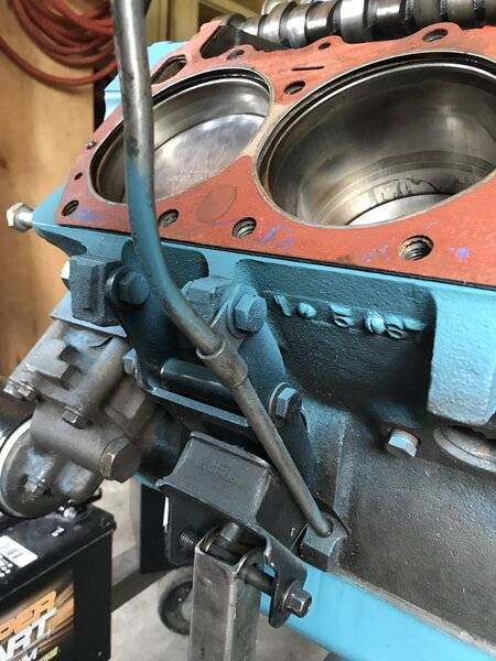

Guys, these mounts were listed as what is needed to install a 440 back into a factory 440 68. Checking them out today I don t see how they bolt to the block...are these correct or am I missing a go between part.....thanks......
And then it should drop right onto the K-frame once the brackets and mounts are bolted to the block so long as the car has a V8 K-frame in it. If it came with a 6, you're gonna have to do different brackets or swap out the K-frame or do some welding.
I got a 440 car one time that had a /6 K-frame in it. Someone needed the V8 one I guess. Did you see the recent post where a guy had 7/16ths" lug studs on the front end of his B body car? My deal happened 30 years ago lol
If he needs a v8 k I have one but it’s for a 66/67 probably would work but not year correct.
Thanks much Guys, posting those pics helped a lot. Figured is was missing something. BeepBeep, I have a homemade engine break in stand and now know what needed to mount the 440 in the stand from your pixs. Awesome ....
