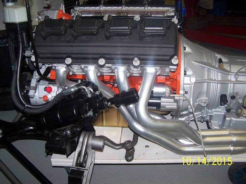

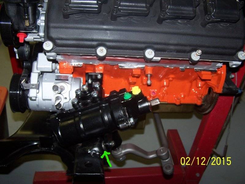

I did this swap on my 68 Charger back in 2015. I bought the Borgeson gear along with the Bergman coupler. No cutting the steering shaft unless you have a manual steering column. The Borgeson box is smaller and about an inch shorter than the factory PS gearbox. The Bergman coupler is fabricated like the original coupler but it is an inch longer and works out perfectly. My Borgeson box didn't line up with my steering column so I added a 1/4" spacer to the 3rd bolt to tip the gearbox in towards the engine putting it in line. I'm not certain but I think the newer version fine tuned the welded ear to fix that issue.Here are a couple pics. One showing the spacer I used to put things in line. The other shows the Bergman coupler installed on the gear. Easy Peasy swap and money well spent.
