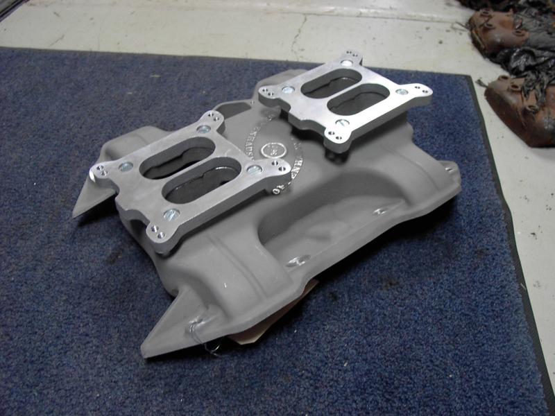

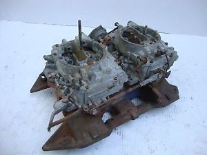

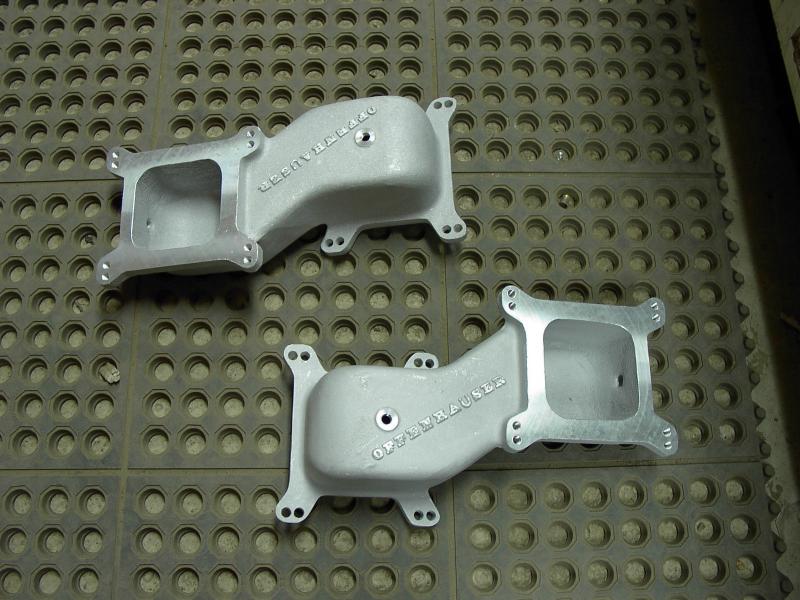

$_35intake.jpg$T2eC16J,!ykE9s7twCSeBRUg,gIh5Q~~60_57.jpg$T2eC16ZHJF0FFZ+MONNmBRk8J,8Pvw~~60_57.jpg works for me! Or mopar dual quads works for me. ON CROSS RAM INTAKE HOLES FOR NOS.....
Mike, can those crossram adapters still be bought if so what is the number and price? Thanks, Steve

I'd like to use a pair of those adapters on a 318 poly 2-4 manifold.
