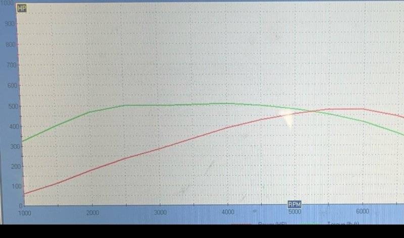

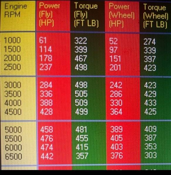

400, RPM heads and intake, 703, headers, 9:1
Generated w Dynosim 5+
That curve tells me a 6400 to 6500 shift.

Good point and driving the car should be pretty obvious as to whether you can get the rpms 10% past peak hp. Will it..?
One way to find out:steering:
