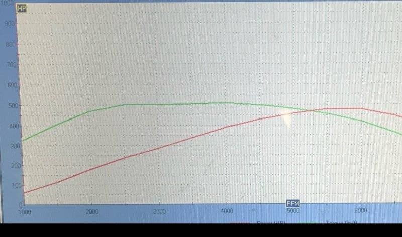

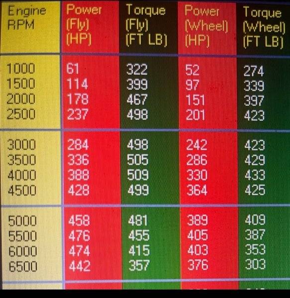

400, RPM heads and intake, 703, headers, 9:1
Generated w Dynosim 5+
Funny! That’s the curve I had in my head.
What cylinder head or flow figures did you or the computer use?
The RPM’s?
looking at the curve i would think of shifting around 5800 when the torque is on the down curve .
That’s called short shifting. You’re leaving a lot on the table in this method. To travel the quickest, a few hundred rpm past peak is what you’re looking for. Otherwise, it depends on the HP curve, or lack of past peak HP to determine where you shift.
When the HP curve falls (dependent on how much and how fast) you want to delay the shift to stay in the highest part of the HP curve and not the torque curve. Travel in the fattest part of the HP curve.

LOL @RemCharger , thanks.
The RPM’s?
Yes, The program has a rpm on file. I don't have the specifics as I am away from it. But I recall they flow in the 280s max and includes the lower lift flows. They are measured flow #s for a actual bb edy Rpm.
peak torque or peak horsepower?
You want to ride the bubble of max average horsepower which would start by shifting 10% rpm higher than the rpm it makes peak horsepower.
(so the horsepower it makes at the top of the gear is the same horsepower it will make entering the next gear when rpm drops)
A 5000 redline is very safe, but limiting performance.
Otoh, peak horsepower for a hi performance 440 was rated at 4700 to 4900.
You have a bit more cam than a stock 440, and much better heads, a bit better intake. My guess? I think it'll make power to 5500, I'd shift it at 5800, I seriously doubt you'll do any damage there.
My 440 with worse heads, lots more cam, spins safely and easily to 6500. But, It doesn't make power there! I used to shift at 6200, but I found it goes just as fast and quick, shifted at 58-5900.
Best suggestion? Get a performance app for your phone (draggie, or something like that, spelling might be wrong) and try shifting 1-2 at 5500, 5800, and 6000, running to 330 feet, and see what is fastest.
