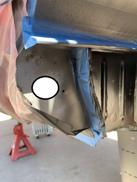

Back end of rocker:

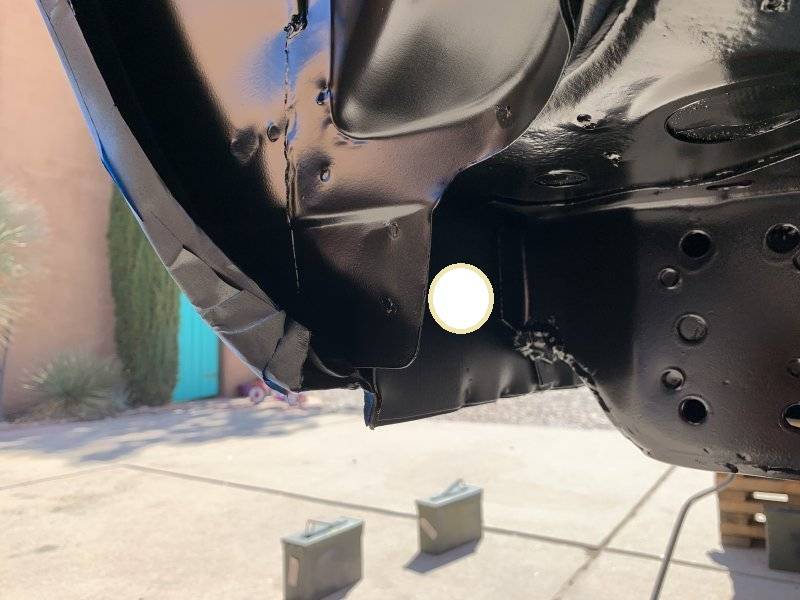

Front end of rocker (the spot welded cap I was thinking of removing):

earlier cars have holes here..... there may be a couple pieces of structure in the rocker, but stuff can get past
