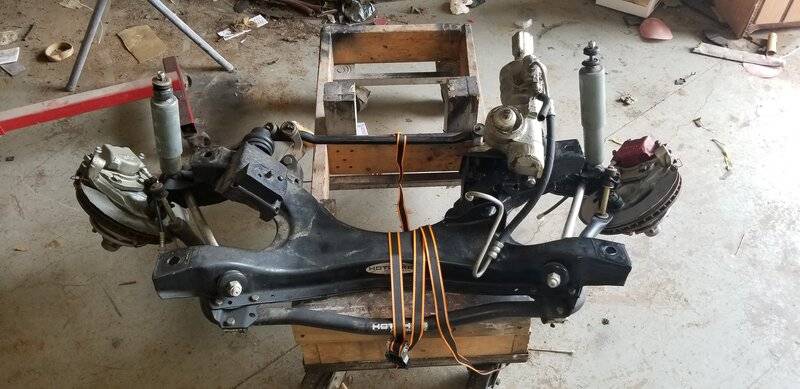

Since your doing suspension as well there’s only one way to go and that’s drop it all out the bottom in one unit.

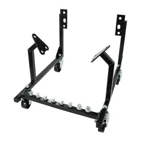

@Beekeeper I love your dolly for removal and installation. Mine is homemade from wood and a old metal cart frame.
I done a parts list and measurements and all after I built it. They are on FABO somewhere
the one you have gets the job done.:thumbsup:
Oh and I need the power steering hose in your pic:lol:

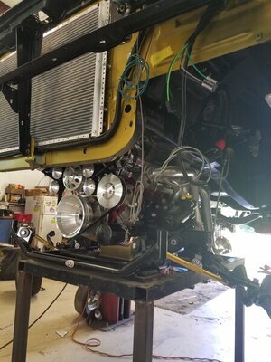

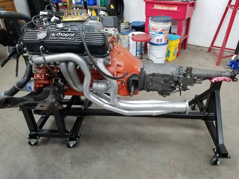

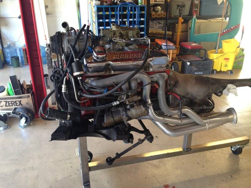

Male a dolly and drop everything from the bottom. I made my dolly high so I could watch everything from the bottom and would not have to get under the car.
Just make sure your balance is good, once you drop everything that rear is going to be the heavy end.
Thank you thank you thank you, that's exactly what I needed to see.
The only dolly I can find around is the one pictured. I need to find something like that T-shaped trolley and modify it from there.
Beekeeper I really like your scissor jack idea.

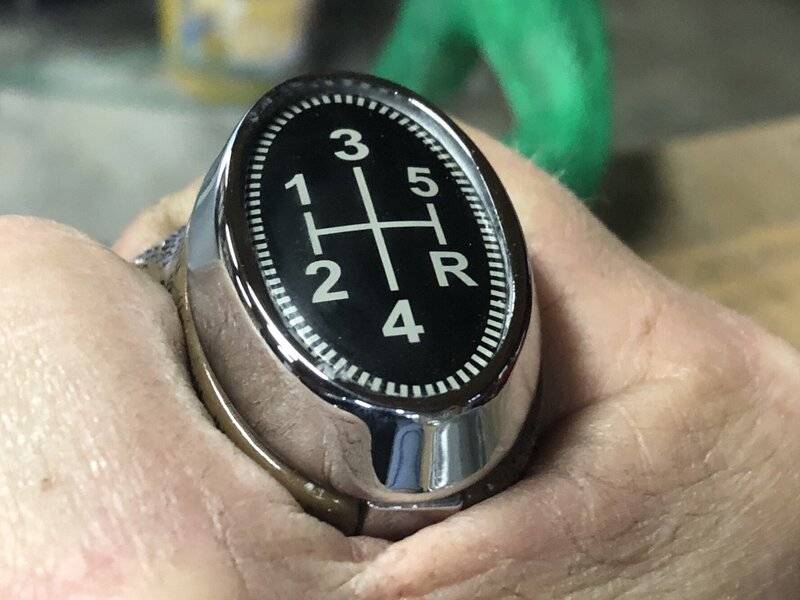

Aha! I see that I was able to sway you to choose the manual transmission!

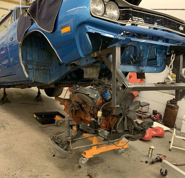

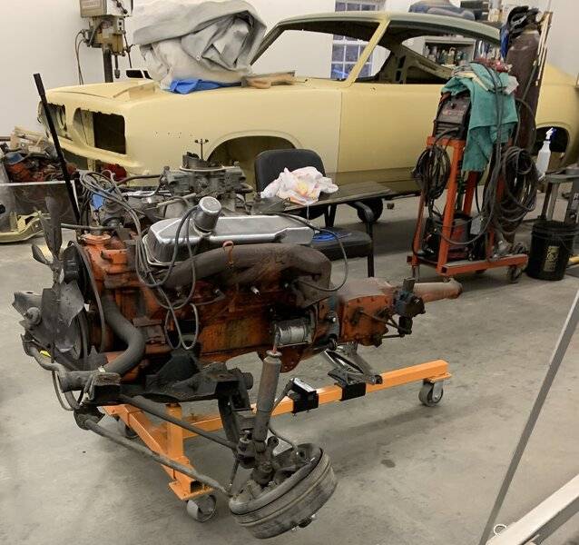

I made a stand a couple years ago and have been dropping them out the bottom as well. It's nice not to have to remove the hood or worry about damaging fenders. Also makes it a pretty easy one man job.
