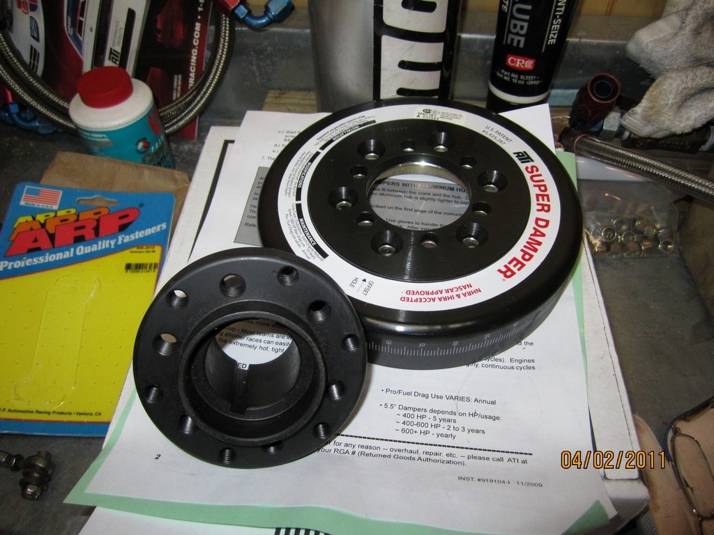

Ran a Fluid damper last 440 , for my 493 i'm using an ATI super damper (three ring) with ARP crank bolt , whats nice is the ATI damper is rebuildable. damper hub must be honed for fit.
