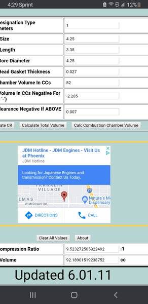

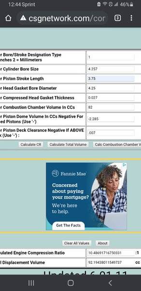

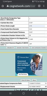

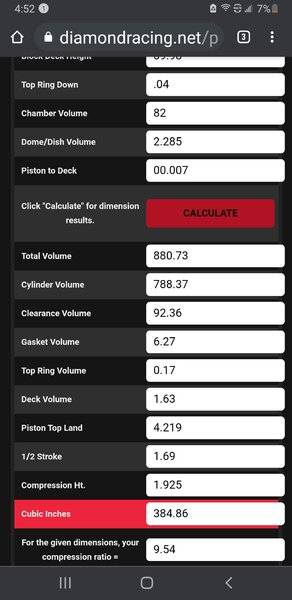

Im coming up with 10.4....does anyone see an error?
Assuming 51.48 is gasket bore? Or what does that represent?
That is a number that you use to basically convert the result to CC's. (for this example) What gasket ( PN#) are you using? You should also be using ARP head bolts or studs. The OEM headbolts will damage the aluminum heads.
Cometic C5459-027 is the gasket
2.88 diameter of dish
.09 depth of dish

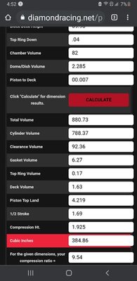

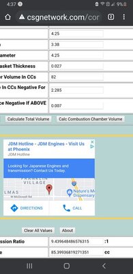

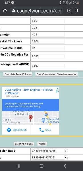

Humor us.. Recalculate using a positive number for piston dome volume.... If positive is wrong your C/R will increase substantially... Ain't no way a 383 with dished pistons is 9.5-1 C/R...
Hmmm dropped to 9.4...
69bee had that formula as ...im guessing ....a TLAR...(That Looks About Right) estimator...i guessing we can assume 10-15% error in it? Id like someone else to run those dish numbers...see how far off base this really is.
Dish is 2.88 diameter x .09 deep.
