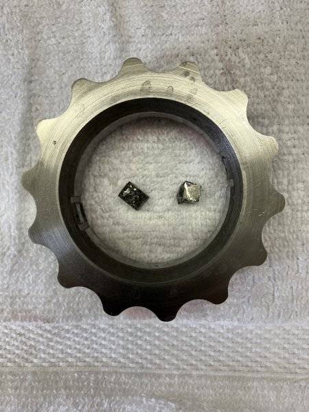

Manual valve is attached... Did you try shifting to neutral & see if the car would roll? Or now that the pan is off have someone shift it while you visually verify the internal linkage is moving...
The pressure regulator is in place & doesn't appear to be stuck.. Gotta wonder if the front pump drive tangs got damaged...
