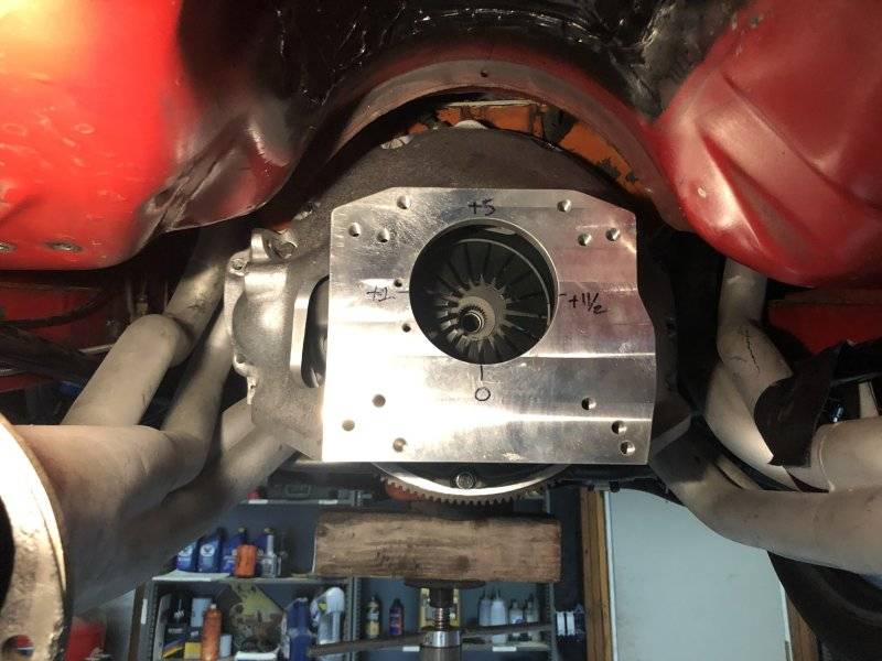

That is odd. My TTI headers cleared my manual bell just fine.I run Doug's Headers. 2" primaries. My bell housing also does not fit between them. So I have to slide the tranny back, then lower, then back, and so on until I get to the widest part of the header, then rotate the tranny about 30 degrees, and down she comes. I'll post a pic when I get mine installed, hopefully before 2025.
The TTI 1 7/8 and their 2" pipes should theoretically be the same aside from the pipe diameter but they are quite different. I don't understand why.
My 2" pipes clear the Fast Ratio steering arms while the 1 7/8" pipes do not.
I only ordered these because they were out of stock on the 1 7/8" pipes when I was ready to buy. I've believed that header pipe diameter should be close to the exhaust valve diameter.

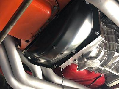

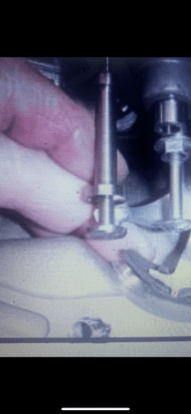

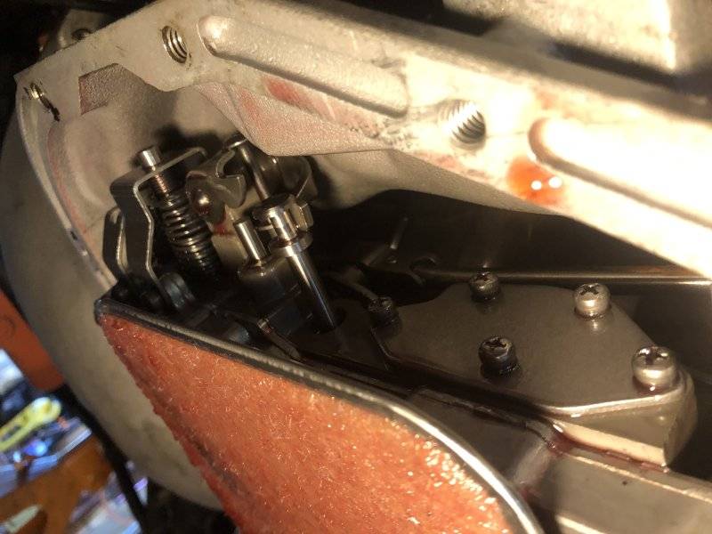

Seriously doubt it's a convertor problem... Check the shifter linkage.... No single band or clutch failing would take out every gear.. But a linkage problem sure will... When you take it out of park can you push the car? Or does it stay in park? sure sign of a linkage problem... But even if it rolls there can be a problem where the main control valve doesn't move... If the external linkages look okay, drop the pan & see if the manual valve is separated from the rooster... See photo...Oh boy, this is what I am facing right now. Transmission rebuilt last year has only about 25 miles on it. Drove the car into the garage last Thursday evening and Friday morning it wouldn't move in any gear. Fluid is out of the bottle clean without any residue. Cooler lines and cooler are not plugged up. Sounds like my TQ probably gave up the ghost
