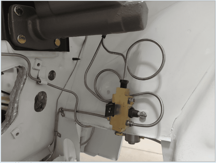

I have the same set-up that you are going to do.
I used the proper proportioning valve.
One of the ports is plugged as I'm also using a line-loc - you can see the bottom of it just under the proportioning valve.
You could use the factory valves, and they would probably work fine, if your system is stock. Any modifications from stock, including tires, or lightweight engine parts ect. could alter the braking balance. One other thing, while I'm here. The brass lump under your master cyl on your drum brake car, as well as the one in post 6 are not proportioning valves. They are pressure differential valves. There were three valves used on most disc brake systems of the Era. The pressure differential, the metering, and the proportioning valves. They combined all three into one combination valve by the early 70s.
