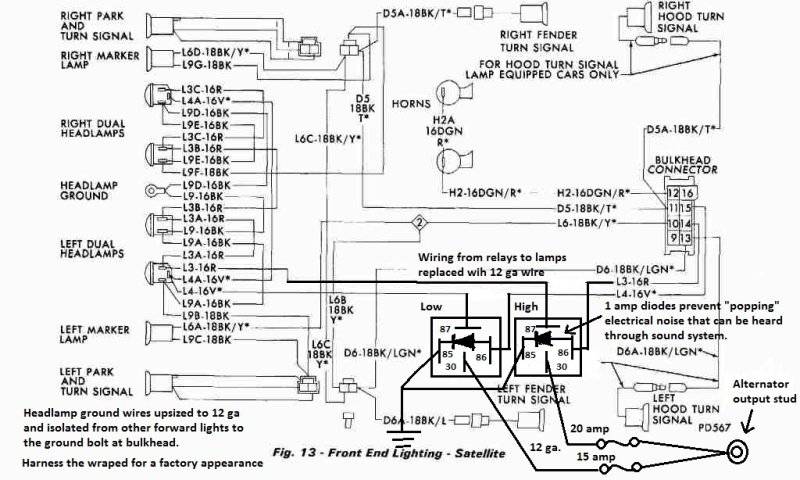

What are you talking about? The starter motor is the only factory load directly connected to the battery, not part of the charging system. This has nothing to do with the starter motor. All other original factory loads are on the alternator side of the ammeter (splice 1 in the dash harness) as should be any added aftermarket loads with an intact factory charging system. There should only be battery charging/discharging current flowing through the ammeter and related connections. Any added loads placed on the battery side of the ammeter will draw it’s current from the alternator through the ammeter while in operation, placing the entire charging circuit (wiring, bulkhead connectors, and ammeter) well outside of its original design limits. Ammeter will also register any added current load at the battery as false charging current. Logic? It’s fact.Sorry,
This ^^^ is nonsense. Using your logic, when the starter is engaged, the bulkhead connections would burn out because of the several hundred amps that the starter draws. Because the starter is also connected to the bat + ve terminal. It would also mean according to the above 'logic', that the huge current draw from the starter cranking would snap off the ammeter needle as it slams the -ve peg!!
I have my own car wired as in post #35, as well as several others, with zero problems.
Funny, you mention voltage drop, the relays by-passing voltage-drop in the original lighting circuit for the lamps, good thing. However, connecting the relay secondary power supply at the battery just shifts any voltage drop concerns away from the lighting circuit and over to the charge circuit as the alternator is providing power to the relays, not the battery, while running. Every bulkhead connection, ammeter and its connections between the alternator and the battery are now contributing to a voltage drop while engine is running.
Once more, this only applies to un-modified stock Chrysler charging systems of this era that includes a functional ammeter as originally equipped.
