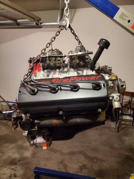

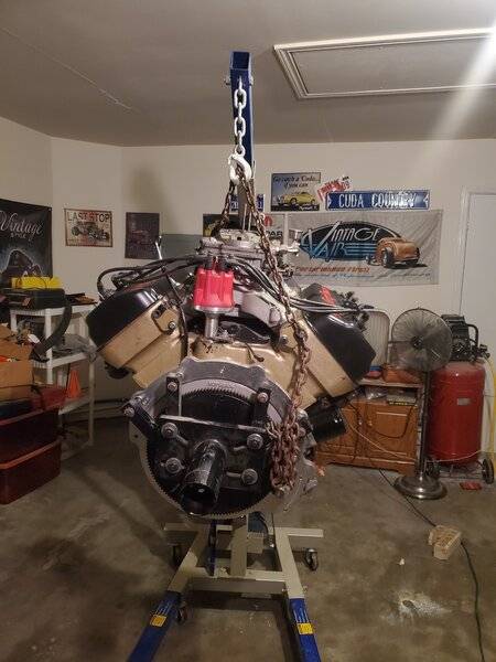

Thanks guys i really appreciate everyones in put. I am movong forward with installing the 354 into the 68 charger. Any one know someone that has done this swap before just to get an idea what will need to be done besides motor mounts. Also here are some pics of the hemi.
That sure rocks the underhood appeal. Looks to be on an intake ready to go? Personally I would find an engine dyno and run it on that? Just to see its pluses and minuses. Like what was mentioned. If it's built lower compression with a more stock cam profile that superchargers typically like? Due to less valve over lap and wide lobe separation. But now on a N/A setup? May very likely be disappointing in performance. REALLY missing its huffer. Again, if you get and can post some engine build specs on your hemi setup? And what supercharger was in mind for the build? Will help tremendously on advise what to expect. The builder may have had other thoughts and ideas all together?
But love the look! I've always liked that old school long oil tube.
They look Kewl... no doubt about that !
That said...
the 354's were typically as slow as fawk.... they really do need a Blower.
I'll 2nd the Dyno it first suggestion.... just to make sure the swap ain't all for nothing.
your main issue as others have realized is the engine is a lot taller than a 440. The crank sits below the block,not in it. and it is 850 plus pounds. then the adaptor for the transmission.
Maybe speed isn't what he's after. With traffic the way it is today it's better to be conservative driving and make it home safe. You still can't beat the look of a Hemi under any hood whether it be 1st or 2nd generation.
