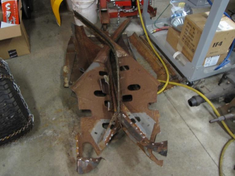

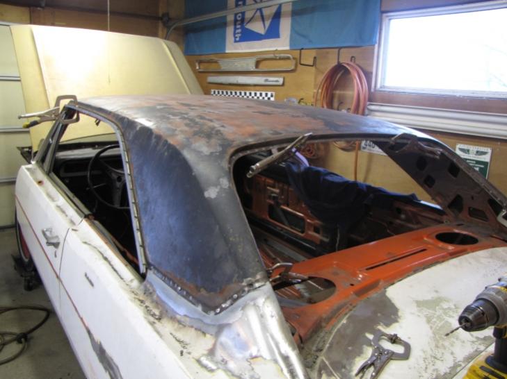

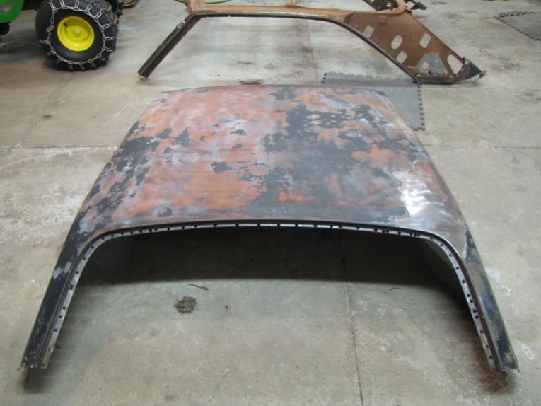

Well today was Round 2 with the donor roof. Lotta jumping around the ring, but I knocked that things teeth out...lol Wrapped up getting the donor roof skin off its interior frame. Pretty happy i'm done with that.

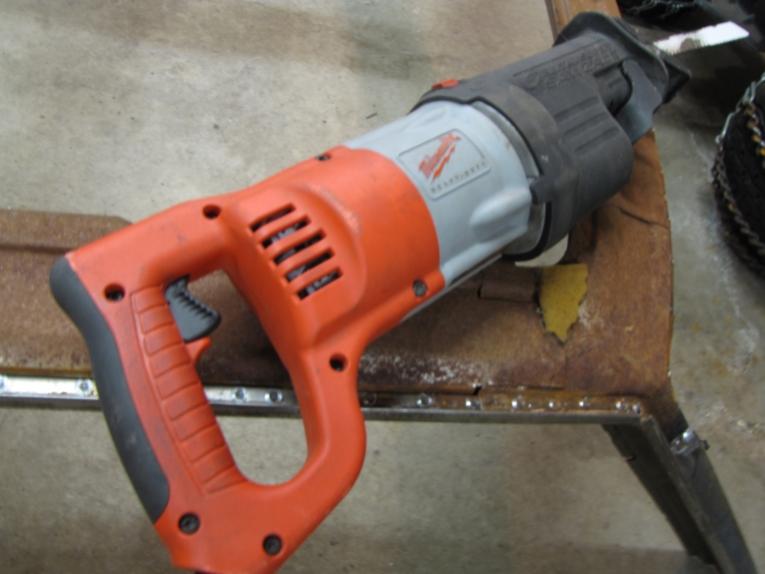

So my Sawzall has been collecting dust, since I cut the donor roof off a now convertible Dart, down the old Kentucky holler. Heck of a tool. I refer to it as "The Angry Badger". Anyways, as usual I tossed on my welding mitt's, safety glasses, pulled the trigger and just held on. Like when cutting off the roof, I had the old frame diced up in about 2-3 minutes. If you guys don't have one of these, and you enjoy destruction, demolition and ceasing life, I highly recommenced one.

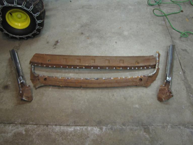

So I'm not too A-Body savoy when it comes to typical A-Body rot problem areas (besides the all-around basic areas). I've been blessed with plenty of run of the mill B-Body problem child areas in the past. Anyways, I saved the A-Pillars, top half of the rear interior window frame, as well as the top of the front window frame. If you guys know anyone looking for one or all the pieces, let me know. Don't want anything for them, just pay for the shipping. Hopefully they'll help someone out down the road.
So now I'm just pegging away at prepping the interior roof and donor roof skin. Cleaning up rust and filling a couple holes where the spot weld cutter popped through.

Angry Beaver, now that is funny! But I know where you are coming from, That Sawzall is my favorite HE MAN tool.
I recommend buying excactly the one pictured. Milwaukee Sawzall WITH a cord, Not those wimpy battery ones.
Thanks Don! I'm sure you do remember your dashing adventures with roof skins. Gotta say, I'd rather weld on a set of quarters. Roofs are kind of drag on work. If figured you'd have a Sawzall as well. I dig my plasma cutter the same, but when there isn't a whole lot of finesse involved, the Milwaukee wins it, hands down. And I agree, 110V eats up the 18V
Had a super sawzall for a lot of years now and really like my plasma cutter too!!
Plasma cutter's are sweet! Makes my cut off wheel seem like a dull butter knife...lol

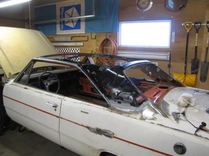

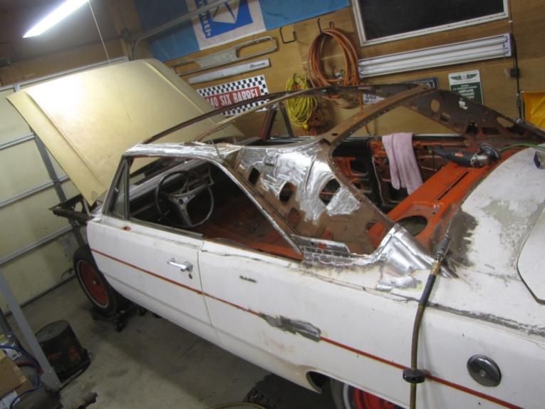

Got some time on the Dodge today......
Prepped the donor roof, and also prepped the inner roof frame. Cleaned it down to all bare metal, sprayed Zinc Weld-Thru primer along all the surfaces to be welded to, then sprayed some PPG DP40 Epoxy Primer over the rest of the frame. Roof brace, I didn't any decent panel adhesive to apply between that and the skin, so I went with some run of the mill Liquid Nails in the caulk gun.
Little tough to put on alone, but the skin is on. Fit like a glove. After calling it a night, I'm about 3/4 the way through welding up all the spot welds.
