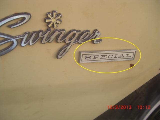

the "special" emblem goes on the fenders.......the reason they put the "dart" emblem on the 1/4 is because it would simply be too crowded on the fender to have "dart" "Swinger" and "special" all together. On a regular order dart swinger (LH23) would have "dart swinger" on the fender and nothing on the 1/4 for 71+
I will warn that the "special" emblem is extremely difficult to find, even I have been on multiple treasure hunts after that emblem. There is supposed to be a cat in Arizona who supposedly has a stock of N.O.S. ones ....if I manage to hunt him down I will definitely share.
This is a pic from my car to show what you are looking at.

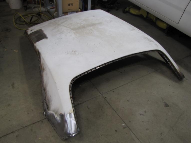

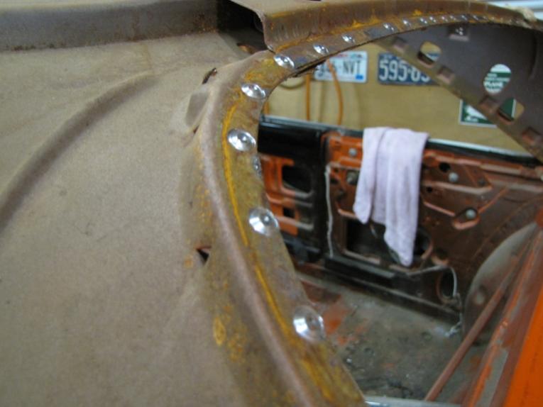

Well.........I officially have a Dart Special with one heck of a Special Sun Roof option now....

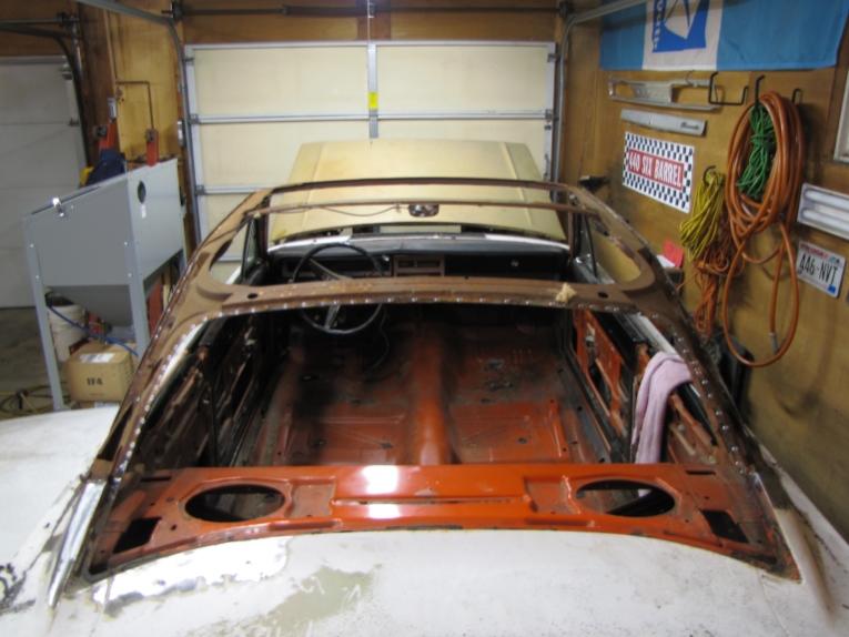

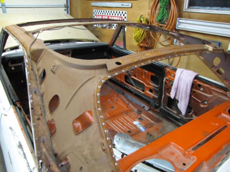

Finally weeded through all the spot welds. Seen some of you other fella's have issues with the Blair Spot Weld Cutters, but mine keep cutting holes through rotten panels like a champ. Don't know if it's because I always use a lot of the Rotabroach lube & machining oil, or just getting lucky. Either way, after drilling out a good hundred of them, i'm quite sick of looking at them.
So on deck for tomorrow is, have a little bit of fun dicing the old roof up into bite size pieces with the plasma cutter. After that i'll be dragging the donor roof inside, so I can start this wonderful process all over again.
