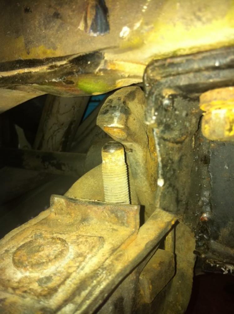

New issue. I got the drivers side in but the adjuster bolt stop arm is all the way up. How do I get it to drop? I had to raise the wheel to align the hex ends and when I dropped the wheel it didn't come back down with the control arm. I hope I decribed this correctly. I still haven't got the other side to go in but that is for another time. Man I am starting to think that I shouldn't have messed with it.
You can loosen the lca nut, that will help. Dont forget to retorque it when you get the weight of the car back on it (wheels on the ground).
i`n not sure if i got you right...
does it look like this?
You don't raise the suspension to insert the bar end... you LOWER it as far as it can go, that means taking the UCA stop bumper off ! You may have to give it a little pry bar assistance to get the bar in, don't forget to swipe a little grease on the stub of the bar.
