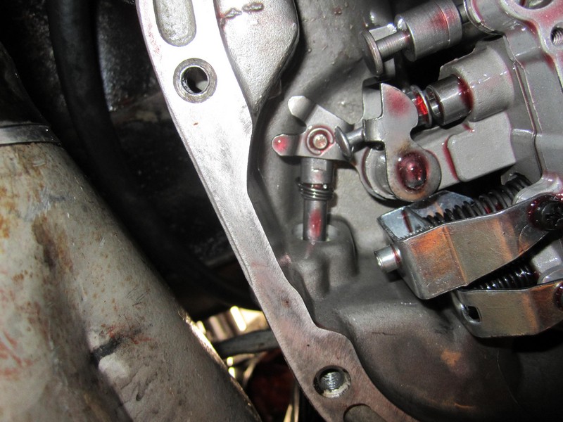

That would be correct,with someone holding the low button. I like to adjust with the pan off so I can see the tit of the rooster at the neutral safety switch.

I had several issues this year with mine. First the plastic style and metal style neutral safety switch's are different lengths. The rooster comb can get hung up on the switch when switching directions. Such as reverse to neutral or drive to neutral. If this is the case you can adjust until the sun sets and it won't fix it. I didn't have the correct switch and plenty of the others so I trimmed the rooster come neutral pin on the grinder. This led me to my next issue. The cable at the shifter end was oversize. I don't know why as it appeared to be made that way. The other cable's I had were tight, but to short. This allowed the cable to be sloppy on the pin. I made bushing out of brass tubing. The next item is that on the transmission end of the inner cable there are two different style "bullets" that correspond to two different style adapters on the valve body. Stop now, pull the pan. Watch the shifter while moving the buttons. (I know upside down under the dash isn't fun.). And then watch the rooster with the pan off while it is being shifted. It will become quite clear whats happening when you watch. Then figure out which parts are miss matched. Correct as necessary. The stack up of mismatched parts in mine hung the manual valve between 2nd and 3rd on a 9.20 pass and locked the rear tires due to being in 2nd and 3rd together, very exciting.
