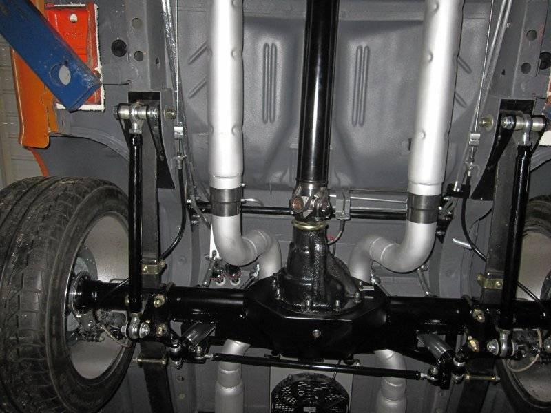

My cars are super stock springs, ladder bars with stock leafs, and four link with coilovers.

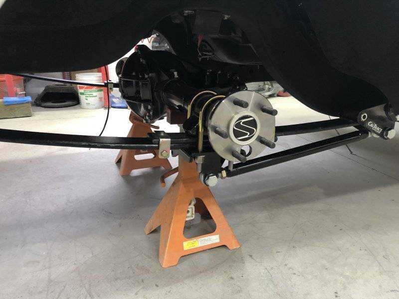

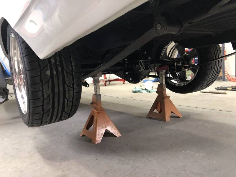

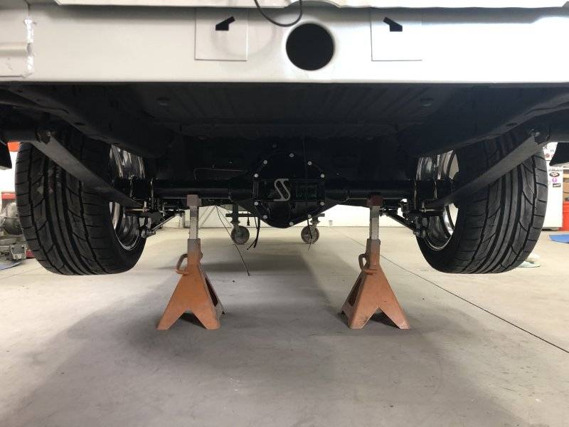

I haven't run them yet but I put them on my 68 Runner street build. Went with the low profiles. This car will never see the drag strip but it's built for it.
