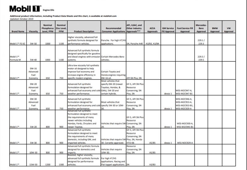

Don't quote me, but I think break in oil has higher zinc levels that regular high zinc oils and I seem to recall reading an article once that said more is not always better regarding zinc levels. I think, if I recall correctly, that there is a point where too much is detrimental. I forget where that level is, but I seem to recall it being somewhere in the neighborhood of 2000 PPM.

I am currently rebuilding a roller cam Magnum 5.9 and will use the Lucas 30w break-in oil. Not as critical with roller cams but will be switching to Mobil 1 Synthetic after 500 miles. Most of their synthetic oils have Phosphorus and ZDDP. There may be others.
