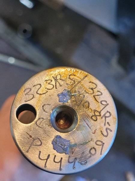

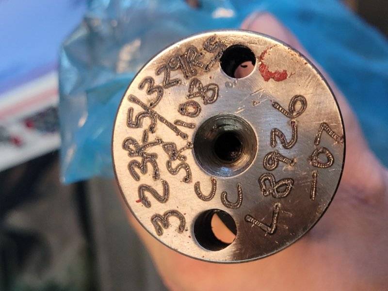

Hi there, I am trying to identify what these numbers mean on these two cams. I figured out its a Comp Cam roller but don't know how to determine the lifts, etc?
#1.
#2.

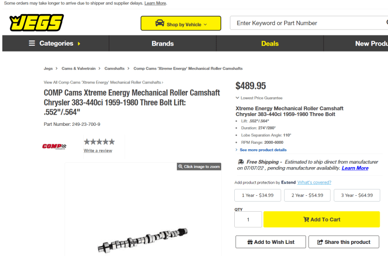

Well that doesn't seem so easy...
I did a little checking but can't correlate the sharpie writing with that cam?
It could be a custom?
Ya, thats what I am thinking. I just dont know how to correctly decipher what the writing translates to in cam specs.

All the Comp cam lobe #s I have are 4 digit, not 3. CC could mean Crane Cams.
Actually, 323-5 and 329-5 are Comp lobes using the older designation.

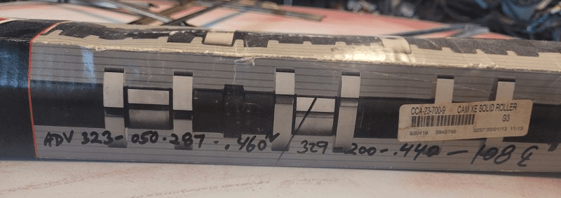

The first cam matches the specs written on the box.
Actually, it appears that both cams are the same grind.
323/329 - @.020
287/292 - @.050
108 - lsa
.460/.440 lobe lift
