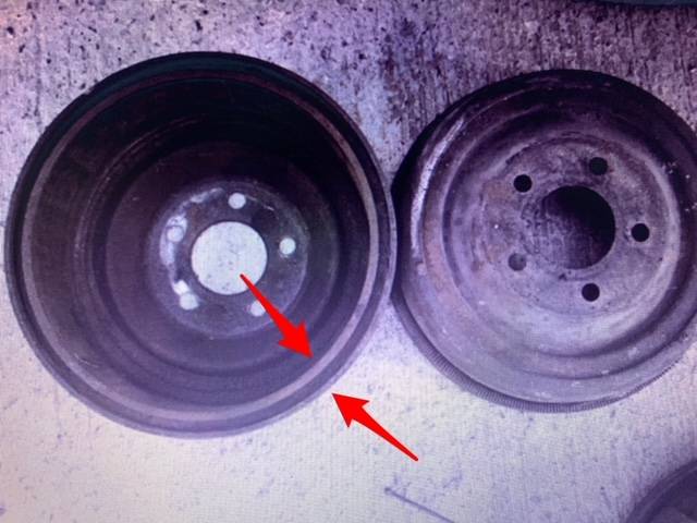

I'm at work. Yes 11.5 was the whole diameter from the outside edge. So if 12.5 is an 11" drum then 11.5 would make sense it's a 10" drum.

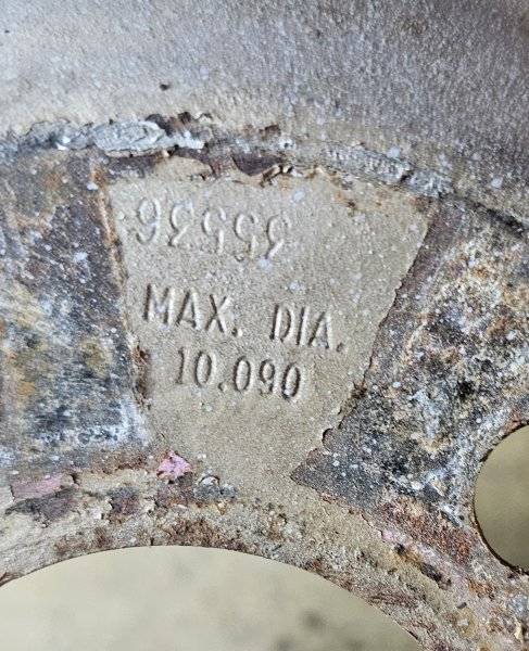

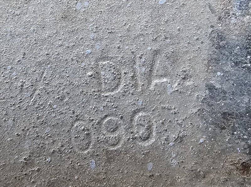

I did take these pictures last night of the markings on the drum.
Max diameter is 10.090.....on the ID where the shoes make contact. I've taken them to 10.125 over before though.
Well, if it states."10.090 Max Diameter" Wouldn't that make it 10" drums?

As I mentioned before stock would be 10.87 and if the car came with discs in the front the rear brakes would be 10" drums.. You have 10" drums so that fits... FWIW most call the 10.87 rotor an 11" rotor...

Yup, 10" drums.....like I said before, got to measure a drum by measuring the I.D. of it (Inside Diameter). For the rotor, take a piece of cardboard and cut out a section of it. Other words, make the cardboard look like a 'C' and make it fit the rotor then measure the opening with a ruler or tape measure.
