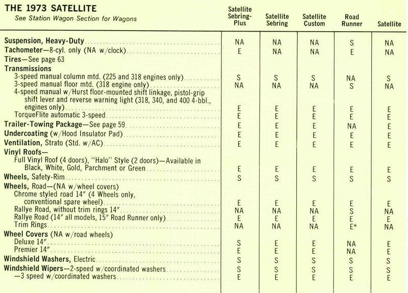

I'm looking for some help from someone who knows a bit about factory options. I have a 73 roadrunner 340 with bucket seats, console and rally dash. I do not have the build sheet and Im wondering what wheels (road wheels or rallys) were standard / optional on my car. I'm pretty sure it would have been ordered by a dealership and isn't any sort of special order car. I know that without the build sheet there is no way of knowing, but I was hoping to get an idea of which ones it would have likely been ordered with. It was originally (and now restored to) JF1 pale green and had the dark green interior. It was built in Canada but I don't know which dealership sold it (if anyone knows how to find out which dealership sold it I'd really appreciate it too). Thanks everyone.

14" Rallyes without trim ring was standard.

I had a 74 RR and it had the rally wheels. Not sure about the seat belt light. See if you can find a manual or look online. Maybe someone here can post one up for you.
