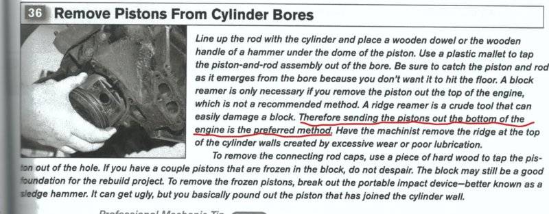

Hi all, I was just reading a rebuild book and it was saying to remove the pistons through the bottom of the motor to avoid using a reamer. Can this be done with the 440?

The answer is NO... The main bearing webbing will interfere... Last engine I saw the pistons come out the bottom of was a 230 inline six...

Why would you want to. The ridge represents wear in the cylinder and you should then use a micrometer to see if boring is needed. Just my opinion.
Even if you could remove them, you wouldn't be able to get a ring compressor in place to put things back together.

I think I saw that article. It's the same one that says you can take the crank out the top!
So I found where I read it. It's HOW TO REBUILD THE BIG BLOCK MOPAR by Arvid Svendsen.
