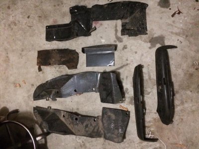

Just like the title says. Found these parts in the trunk and would like to know where they go so I can place them during the rebuild. Thanks for any help. image1.jpg
Bottom left are a pair of fender splash shields. To the right of them, looks like maybe some seat rail covers (?). Square thing in the center looks like a K frame splash shield. The rest are hard to tell in that picture. Might help to know what kind of car they came off of.
BadVert is correct as far as I can see. The ones at the very top look to be headlamp splash shields, sit in the very front of the fender but they don't look like 66-7, possibly 68-9.
One is the front rail splash shield as well under those. Some call it the starter splash shield.
Thanks guys, sorry thought i put that they were in the back of my 66 charger. These are the only ones i'm not familiar with, but getting there. Thanks again

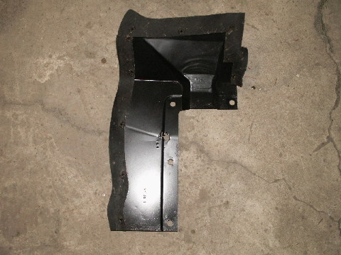

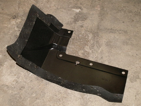

Well here are a couple shots of the splash shields from my 67. Those look a little different but you can compare.
The seat sides could very well be the same and fender shields could also.
