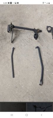

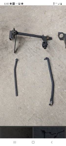

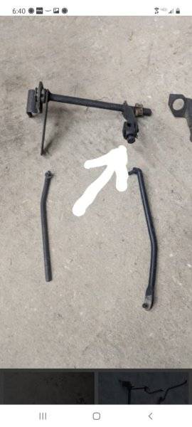

It sounds like your linkage needs adjusted.. There should be a bolt that clamps down on the shift rod that you can adjust. Take the jam nut/bolt loose then put the shift lever in park with it loose. Then tighten it back up. Not sure if this is what linkage you have but this picture you can see the adjuster in the picture.
